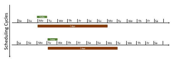

    • If you select Rolling, the duration of the fixed time fence stays constant while the start date shifts by a day, each day.
      • If the anchor time is midnight, and the schedule refresh is performed after midnight on the same day, the fixed time fence is counted from midnight on that day, regardless of what time the schedule refresh is performed.
        UI settings in the rolling type description for when the anchor time is midnight.
        Diagrammatic representation of the rolling type description for when the anchor time is midnight.

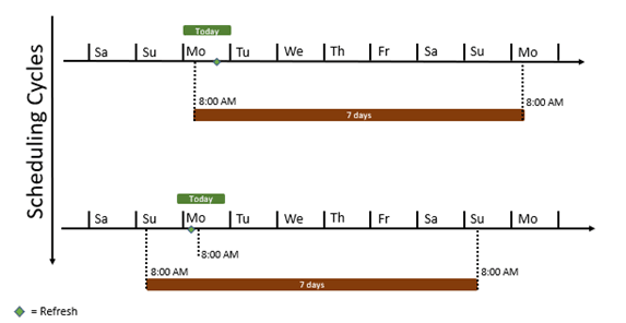

      • If the anchor time isn't midnight, let's say it's 8:00 a.m. today, and a schedule refresh is done after 8:00 a.m. today, then the horizon start and fixed time fence start is 8:00 a.m. today. But if a refresh is performed before 8:00 a.m. on a given day, the horizon start time fence start is 8:00 a.m. the previous day.
        UI settings in the rolling type description for when the anchor time is 8 am.
        Diagrammatic representation of the rolling type description for when the anchor time is 8 am.

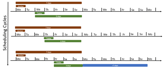

    • If you select Dynamic, the horizon start is the current day, and the time fence shrinks with each passing day until it reaches a time fence minimum duration. When this minimum value is reached, the time fence gets extended. If you select this extension type, you must also specify the time fence minimum duration and time fence extension duration.
      • The time fence shrinkage is the difference between the fixed time fence duration and the number of days between the current day and the last day of the time fence. So if the anchor date and time is Monday 12:00 a.m., the fixed time fence duration is 7 days, and you're refreshing the schedule at Thursday 12:00 a.m., the time fence has shrunk to 4 days. If you set the minimum as 4 days and the extension as 7 days, then from Friday 12:00 a.m., the time fence will have shrunk to 3 days, which is below the limit of 4 days, and will extend by the extension duration of 7 days. This results in a total time fence duration of 10 days.
        UI settings for the dynamic type description.
        Diagrammatic representation of the dynamic type description.
