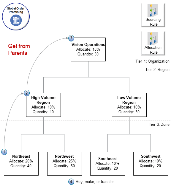

Get Supply from a Node's Parent
Set up a hierarchy that gets supply from a node's parent and distributes it to other nodes.
Assume you have this hierarchy, and you will get supply for the sales order from all three levels of the hierarchy.
Here's the sequence that Promising will use to allocate supply. It’s the same one that's in Use Lower Priority Supply to Fulfill Higher Priority Demand but with a few important differences:
| Step | Description | Remaining Balance |
| 1 | You create a Sales Order in the Northeast node for the AS54888 computer with a quantity of 100, and Order Management populates the three attributes that you reference in your allocation hierarchy to All, High Volume, and Northeast. Promising consumes all 40 units of the supply that's available to allocate in the Northeast node, which is in the lowest level, first. | 220 minus 40 equals 180. |
| 2 | Promising consumes the 10 units of supply that's available to allocate in Northeast's parent, High Volume Region. | 180 minus 10 equals 170. |
| 3 | Promising still needs 170 units, so it consumes the 30 units that are available in High Volume's parent, Vision Operations. | 170 minus 30 equals 140. |
| 4 | Promising still needs 140 more units to fulfill the 220 units on the order line, so it uses your ATP rules and sourcing rules to make, buy, or transfer the remaining 140 units. | 140 minus 140 equals 0. |

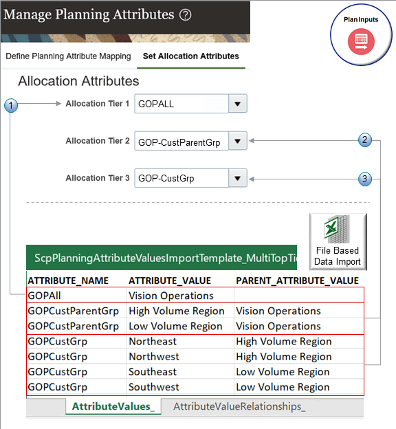

Specify the Hierarchy
- Go to the Plan Inputs work area, then click Tasks > Manage Planning Attributes.
- On the Define Planning Attribute Mapping tab, use the Create action three times
to create these attributes.
Attribute Name Planning Attribute Type Data Type GOPCustGrp Netting and Allocation Attribute Character GOPAll Netting and Allocation Attribute Character GOPCustParentGrp Netting and Allocation Attribute Character Leave the Oracle Fusion Value Set attribute empty.
- Click Set Allocation Attributes. Make sure you enabled the features earlier in this procedure. If you didn't, you won't see the Set Allocation Attributes tab.
- Set the values.
Attribute Value Allocation Tier 1 GOPAll Allocation Tier 2 GOPCustParentGrp Allocation Tier 3 GOPCustGrp - Click Save and Close.
Promising automatically creates an attribute set named BM_Attr_Hrcy. You must use this value when you import. We'll show you how next.

Assume you need to create this hierarchy.
Vision Operations
High Volume Region
Northeast
Northwest
Low Volume Region
Southeast
Southwest
The text might be hard to read in the illustration, so here is the same data from the AttributeValues tab:
| SR_INSTANCE_CODE | ATTRIBUTE_NAME | ATTRIBUTE_VALUE | PARENT_ATTRIBUTE_VALUE |
| GOP | GOPAll | Vision Operations | - |
| GOP | GOPCustParentGrp | High Volume Region | Vision Operations |
| GOP | GOPCustParentGrp | Low Volume Region | Vision Operations |
| GOP | GOPCustGrp | Northeast | High Volume Region |
| GOP | GOPCustGrp | Northwest | High Volume Region |
| GOP | GOPCustGrp | Southeast | Low Volume Region |
| GOP | GOPCustGrp | Southwest | Low Volume Region |
Note these requirements for the AttributeValues tab. You must include:
- A separate row for each node in the top tier of your hierarchy, a separate row each node in the middle tier, and a separate row for each node in the bottom tier. Each row establishes the relationships between all nodes in the hierarchy.
- To specify a top level node, include the value GOPAll in the ATTRIBUTE_NAME column, and include the name of the top level node in the ATTRIBUTE_VALUE column, such as Vision Operations. GOPAll establishes the top tier. All the rows that have GOPAll will be part of your top tier.
- To specify a node in the middle tier of your hierarchy, include the value GOPCustParentGrp in ATTRIBUTE_NAME, include the name of the node in ATTRIBUTE_VALUE, such as High Volume Region, and include the name of this row's parent in PARENT_ATTRIBUTE_VALUE, such as Vision Operations. GOPCustParentGrp establishes the middle tier. All the rows that have GOPCustParentGrp will be part of your middle tier.
- To specify a node in the bottom tier of your hierarchy, include the value GOPCustGrp in ATTRIBUTE_NAME, include the name of the node in ATTRIBUTE_VALUE, such as Northeast, and include the name of this row's parent in PARENT_ATTRIBUTE_VALUE, such as High Volume Region. GOPCustGrp establishes the bottom tier. All the rows that have GOPCustGrp will be part of your bottom tier.
GOP, GOPAll, GOPCustParentGrp, GOPCustGrp are all example values. You don't have to use them. You can use whatever values you need to represent your supply chain.

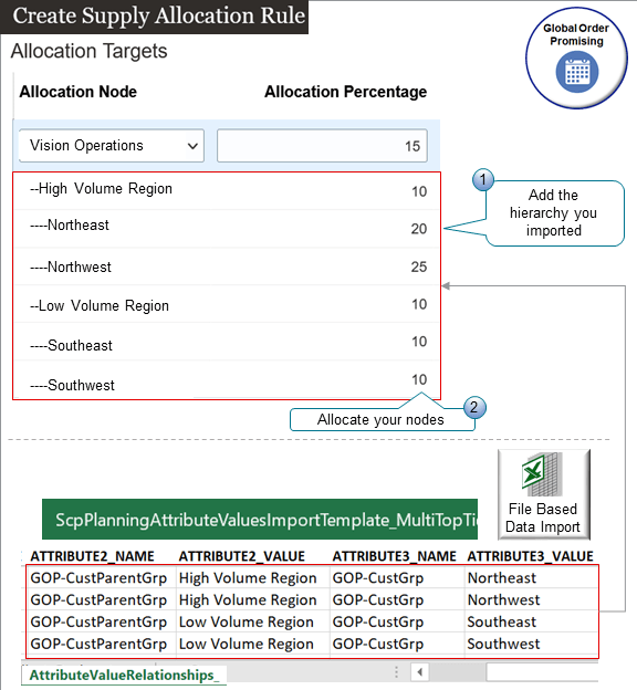

Moving on, here is the data from the AttributeValueRelationships tab.
| ATTRIBUTE_SET_NAME | ATTRIBUTE1_NAME | ATTRIBUTE1_VALUE | ATTRIBUTE2_NAME | ATTRIBUTE2_VALUE | ATTRIBUTE3_NAME | ATTRIBUTE3_VALUE |
| BM_Attr_Hrcy | GOP-Vision Operations | Vision Operations | GOP-CustParentGrp | High Volume Region | GOP-CustGrp | Northeast |
| BM_Attr_Hrcy | GOP-Vision Operations | Vision Operations | GOP-CustParentGrp | High Volume Region | GOP-CustGrp | Northwest |
| BM_Attr_Hrcy | GOP-Vision Operations | Vision Operations | GOP-CustParentGrp | Low Volume Region | GOP-CustGrp | Southeast |
| BM_Attr_Hrcy | GOP-Vision Operations | Vision Operations | GOP-CustParentGrp | Low Volume Region | GOP-CustGrp | Southwest |
Note these requirements for the AttributeValueRelationships tab. You must include:
- The value BM_Attr_Hrcy in the ATTRIBUTE_SET_NAME column, and you must include this value in each row that has data. BM_Attr_Hrcy means Backlog Management Attribute Hierarchy. Don't worry. We aren't using Backlog Management. We're using this value because we share this logic with other Oracle Applications, such as Oracle Backlog Management.
- A separate row for each node in the bottom tier of your hierarchy. Each row establishes a relationship between the bottom node, that node's parent, and the bottom node's grandparent.
- The name of the bottom node's grandparent in ATTRIBUTE1_VALUE, and preface it with the text GOP-. For example, GOP-Vision Operations.
- The name of the top node in ATTRIBUTE1_VALUE, such as Vision Operations.
- The value GOP-CustParentGrp in ATTRIBUTE2_NAME, and you must include this value in each row that has data.
- The name of the bottom node's parent in ATTRIBUTE2_VALUE. For example, in the row that has Northeast in ATTRIBUTE3_VALUE, include the value High Volume Region in ATTRIBUTE2_VALUE.
- The value GOP-CustGrp in ATTRIBUTE3_NAME, and you must include this value in each row that has data.
- The name of a node that resides in the bottom tier in ATTRIBUTE3_VALUE, such as Northeast.

Create an Allocation Rule
You will add the nodes that you imported as a hierarchy, and then allocate each one of them.
Try it.
- Go to the Order Promising work area.
- Click Tasks > Manage Supply Allocation Rules.
- On the Manage Supply Allocation Rules page, search for the value.
Attribute Value Name Supply for Vision Operations Specification Type Percentage - Click Actions > Edit.
- On the Allocation Targets tab, click Actions > Add Row, then set the
values.
Attribute Value Start Date Choose a Sunday. End Date Choose a Sunday. Each allocation rule works on a weekly basis that starts and ends on Sunday.
- In the Allocation Targets area, click Actions > Add Row to add each
node.
Allocation Node Allocation Percentage Vision Operations 15 High Volume Region 10 Northeast 20 Northwest 25 Low Volume Region 10 Southeast 10 Southwest 10 Note
- Set the Node Rank attribute to zero.
- Set the Stealing Protection Percentage attribute to zero.
- Don't set any values in the Date Range to Consider Shipping History area or in the Allocation Targets area.
- Notice that the page automatically prefaces each node with a series of hyphens. This isn't part of the node's name, but it does help you to visualize the hierarchy.

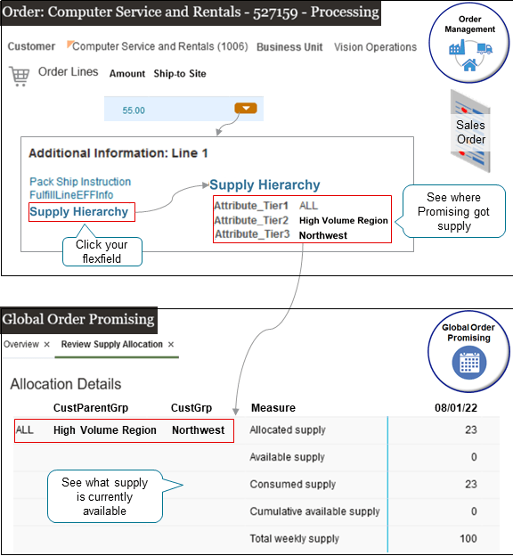

For the final part of the set up, you create a sales order and verify that Promising correctly allocated supply.
You will:
- Use the Order Management work area to create a sales order. You submit the order, then examine the extensible flexfield that you set up to see how Promising allocated supply for the order line.
- Use the Global Order Promising work area to get details about the current supply, such as what supply has Promising allocated in the Northwest node, what supply is available, what supply has Promising consumed to meet demand, and so on.
- Examine your allocations.
- Go to the Global Order Promising work area, and then click Open.
- In the dialog that displays, click the row that says Review Supply Allocation in the Name attribute.
- On the Review Supply Allocation page, set the values, then click
Apply.
Attribute Value Organization Vision Operations Item AS54888 Allocation Nodes Select them:
- All
- High Volume Region
- Low Volume Region
- Northwest
- Northeast
- Southwest
- Southeast
- Examine the values in the Allocation Details area. Notice that Promising will allocate quantities for each node according your setups.
- Create a sales order.
- Go to the Order Management work area, then create a sales order.
Attribute Value Customer Computer Service and Rentals Business Unit Vision Operations - Add an order line and set these attributes.
Attribute Value Item AS5488 - Click Submit.
- On the order line, click the down arrow, then click View Additional Information.

- Examine the revised allocation.
- Repeat step 1.
- In the Allocation Details area, notice how Promising consumed supply
according to your allocation set up. It consumed all the supply for the
Northwest node first. It then consumed supply from the Northwest Region
in the middle tier, and finally then the Vision Operations node in the
top tier. It consumed supply from Northwest's parent and then
Northwest's grandparent until it had all the supply it needed to meet
demand.
