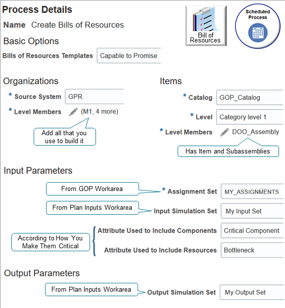

Run the Scheduled Process
You use the Create Bills of Resources scheduled process.
Set the parameters.
| Parameter | Value |
| Bill of Resources Template |
You typically set this attribute to Capable to Promise. If you're migrating your work definitions, then set it to Unfiltered Capable to Promise. Don't set it to Item Level for Aggregate Planning. That value is for another application. |
| Plan | Leave this parameter empty. |
| Source System | Select the system that contains the organizations that contribute to making the item available in your supply chain. |
| Level Members in the Organizations area |
Select all the organizations that contribute to making the item available. Assume you build the item in your M1 Warehouse and M2 Warehouse, and that these warehouses transfer in a subassembly for the item from your M3 Factory, M4 Factory, and S1 Supplier. You would select:
The value that you set in the Source System parameter determines the members you can select. |
| Catalog | Select the same catalog that you use on your assignment set, such as GOP_Catalog. |
| Level |
Category Level 1 The scheduled process comes predefined to use Category Level 1 for GOP_Catalog. In most situations, you use GOP_Catalog and Category Level 1. For details about catalogs and categories, see How Catalogs Work Together. |
| Level Members in the Items area |
Select the categories of items that you want to use in the bill of resources. For example, if you select DOO_Assembly, then the bill of resources will have items that are in the DOO_Assembly category. Make sure the item and all the subassemblies that you use to build the item are in the category that you select. If they aren't, then you need to add them to the category before you can run the scheduled process. |
| Assignment Set |
Select the assignment set that has the sourcing rules that you use to promise. You use the Global Order Promising work area to create the set. The scheduled process will use these rules as input to the bill of resources that it creates. |
| Input Simulation Set |
Select the simulation set that you created in the Plan Inputs work area specifically for this run of this scheduled process. You can use different input simulation sets to create different bills of resources, examine how each one performs, then select the one that works best for you. |
| Attribute Used to Include Components |
If you set the Bill of Resources Template parameter to:
| Attribute Used to Include Resources |
You must make each resource a critical resource, If you make them critical by:
| Bill of Resources Structure | You must use Within Organization. |
| Planning Product Level | You must use Item. |
| Output Simulation Set |
Select the simulation set that you created in the Plan Inputs work area specifically for this run of this scheduled process. Select a set that's different from the set that you specify in the Input Simulation Set parameter. You can use different output simulation sets to create different bills of resources, examine how each one performs, then select the one that works best for you. |
