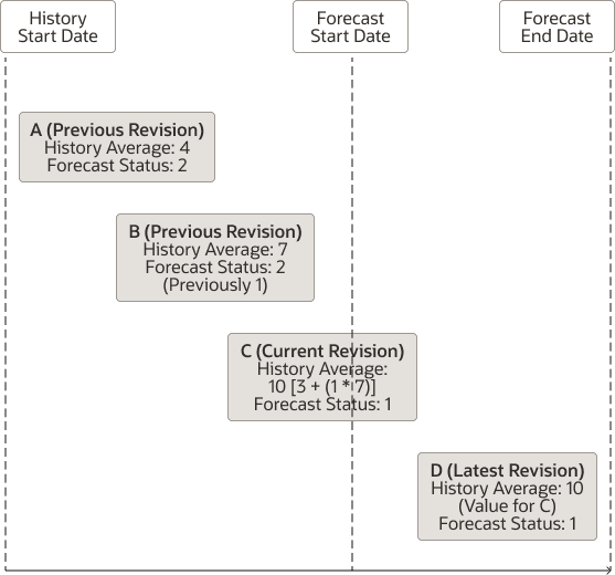

Consider an example in which a supersession chain has previous revisions A and B, current revision C, and latest revision D:
- For A, the value of the history average measure is 4. The value of the forecast status measure is 2.
 - For B, the value of the history average measure is 7. The value of the forecast status measure is 1.
 - For C, the value of the history average measure available up to the plan start
                    date is 3. The value of the forecast status measure is 1.
Thus, the final value of the history average measure for C is 10 [3 + (1 * 7)].
 - For D, the value of the history average measure is 10 (the value of the measure for C). The value of the forecast status measure is 1.
 - After the final values of the history average measure for C and D are calculated, the value of the forecast status measure for B is set to 2.
The following figure depicts this example:
