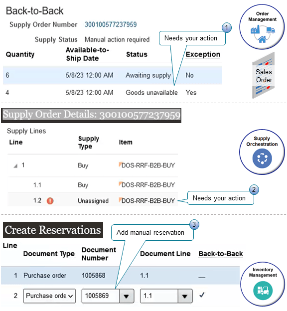

Here's a summary of how it works.
You can:
  1. Examine the order line in the Order Management work area and notice that there isn't enough quantity to fulfill demand.
  2. Click the supply order number, then examine the supply order details in Supply Chain Orchestration to see what supply needs your action.
  3. Use the Inventory Management work area to manually create a reservation. You can then use the Supply Orchestration work area to view that manual reservation.
Note

Assume you receive a call from your Computer Service and Rentals customer and they want an update on sales order 522478.
  1. Make sure you have these privileges:
    • Initiate Order (FOM_CREATE_ORDER_PRIV)
    • Submit Order (FOM_SUBMIT_ORDER_PRIV)
  2. Go to the Order Management work area, query for, then open sales order 522478.
  3. On the Order page, click Actions > Switch to Fulfillment View.
  4. Click Fulfillment Lines.
  5. In the Fulfillment Line section, click Supply Details, then examine values in the Back-to-Back section.
    Attribute Value
    Supply Order Number 300100577237959
    Supply Status
    Manual Action Required
    This means there isn't enough supply to fulfill the order line's demand, so you need to take a manual action.
  6. Notice the values in the Supply Line Information section. A quantity of 6 is available and awaiting supply but a quantity of 4 isn't available.
    Quantity Available to Ship Date Status Exception
    6 5/8/23 12:00 AM Awaiting Supply No
    4 5/8/23 12:00 AM Goods Unavailable Yes
  7. Click the link in the Supply Order Number attribute, then notice that you are now on the Supply Order Details page in the Supply Orchestration work area.
  8. Notice the values in the Supply Lines area.
    Line Supply Type Item Requested Quantity Fulfilled Quantity Status
    1 Buy AS54888 Desktop Computer 10 - In Process
    1.1 Buy AS54888 Desktop Computer 6 - Awaiting Receipt
    1.2 Unassigned AS54888 Desktop Computer 4 0 Not Started
    Note
    • Line 1.1 tracks supply that's awaiting receipt.
    • Line 1.2 isn't assigned yet. This is the line that requires your manual action, such as creating a manual reservation to another source of supply that resides outside of Supply Chain Orchestration. Supply Chain Orchestration won't track this supply, but you can use the Supply Chain Orchestration work area to monitor the manual reservation.
Create the Manual Reservation
  1. Go to the Inventory Management work area, then click Tasks > Manage Reservations and Picks.
  2. On the Manage Reservations and Picks page, Click Create Reservations.
  3. On the Create Reservations page, set the values, then click Search.
    setAttribute Value
    Organization
    M1
    Assume you typically use the M1 warehouse.
    Demand Document Type Sales Order
    Demand Document Number
    522478
    This is the sales order number.
  4. Examine the search results. They contain the inventory reservations that currently exist for the sales order. Assume you see one line in the results.
    Organization Item Customer Document Type Document Number Reserved
    1 AS54888 Desktop Computer Computer Service and Rentals Sales Order 522478 6
    Next, you will add more supply for the sales order.
  5. In the Organization (M1) section, below the search results, click Select and Add (an icon that looks like a page with a plus sign).
  6. Find some supply.
    • Check to see if there's any quantity that's already on hand in inventory. Set the value, then click Search.
      Attribute Value
      Supply Document Type On Hand
      If there's any inventory on hand, you'll see some results below the search section. For this example, assume there's no on hand inventory, and there are no results below the search section.
    • Check to see if there's already a purchase order that has some supply that you can use. Set the value, then click Search.
      Attribute Value
      Supply Document Type Purchase Order
    • Assume your search returns these results.
      Supply Document Number Supply Document Line On Hand Available to Reserve Reserved Quantity
      1005869 1.1 10 0 Empty
      1005812 1.1 10 0 Empty
      1005868 1.1 10 5 Empty
      Purchase orders 1005869 and 1005812 don't have any supply that's available to reserve. However, purchase order 1005868 has 5 available. You need 4, so enter 4 in the Reserved Quantity attribute in the row that has purchase order 1005868, then click OK.
      Success! You just made a manual reservation.
  7. Go back to the Manage Reservations and Picks page. In the Details section, on the Reservations tab, notice that your sales order now has two reservations, one that Supply Chain Orchestration automatically created, and one that you manually created.
    Line Document Type Document Number Back to Back Reserved Quantity
    1 Purchase Order 1005868 Doesn't contain a check mark. 4
    2 Purchase Order 1005869 Contains a check mark. 6
    Also, notice that the Back to Back attribute for your manual reservation on line 1 doesn't contain a check mark.

Examine Your Manual Reservation in Supply Chain Orchestration
  1. Click the 300100577237959 link in the Supply Order Number attribute, then notice that you are now on the Supply Order Details page in the Supply Orchestration work area.
  2. Click Refresh, then expand line 2 in the Supply Lines area.
    1 Buy AS54888 Desktop Computer 10 In Process
    1.1 Buy AS54888 Desktop Computer 6 Awaiting Receipt
    2 Buy AS54888 Desktop Computer 4 In Process
    2.1 Buy AS54888 Desktop Computer 4 0 Awaiting Receipt
  3. Notice the new supply line 2 for your manual reservation. Also note that there's an icon next to the line number for line 2. The icon indicates that the line represents a manual reservation.
    Line 2 represents the purchase order that you used to make the manual reservation and line 2.1 represents the manual reservation. You can view lines 2 and 2.1 but you can't edit them.
