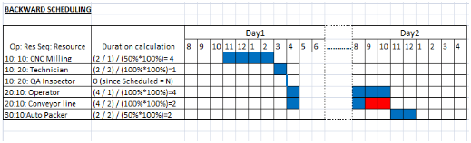

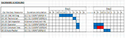

Backward Scheduling
If the work order is created using the completion date of day 2 at 1:00 p.m., the application backward schedules the work order and computes the start date as day 1 at 9:00 a.m. The resource duration is displayed in the following chart:
The following figure shows Backward Scheduling with six resources:
      If the work order is created using the completion date of day 2 at 1:00 p.m., the application backward schedules the work order and computes the start date as day at 11:00 a.m.
The following table presents the information that has been explained diagrammatically for Backward Scheduling:
                      Operation Sequence  |
                      Resource Sequence  |
                      Resource Name  |
                      Resource Duration  |
                      Scheduled Dates With Explanation  |
                      30  |
                      10  |
                      Auto Packer  |
                      (2/2) / (50%*100%) = 2 hours  |
                      Backward Scheduling logic is applied and we start with the last resource of the last operation and compute the start date by scheduling operations in a reverse sequence of forward scheduling. Since the work order is being requested to be completed on day 2 1:00 p.m., and the Auto Packer resource requires 2 hours, Packing operation starts on day 2 at 11:00 a.m. and ends at 1:00 p.m.  |
                      20  |
                      10  |
                      Conveyor Line  |
                      (4/2) / (100%*100%) = 2 hours  |
                      Next the prior operation Assembly is scheduled. The Conveyor Line resource used in this operation is unavailable for 2 hours on day 2 from 9:00 a.m. to 11:00 a.m., and so the application doesn't schedule this resource during that period. The Conveyor Line resource is used in Assembly operation and is scheduled from 8:00 a.m to 9:00 a.m. on day 2, and 4:00 p.m. to 5:00 p.m. on day 1.  |
                      20  |
                      10  |
                      Operator  |
                      (4/1) / (100%*100%) = 4 hours  |
                      The Operator working in the Assembly operation takes 4 hours to complete the task and is scheduled from 8:00 a.m. to 11:00 a.m. on day 2, and 4:00 p.m. to 5:00 p.m. on day 1.  |
                      10  |
                      20  |
                      QA Inspector  |
                      (0 hours (Since Scheduled= N)  |
                      The QA Inspector has no duration but shares the same resource sequence as the Technician, so the scheduled start and end times is 4:00 p.m. on day 1.  |
                      10  |
                      20  |
                      Technician  |
                      (2/2)/ (100% *100%) = 1 hour  |
                      The Technician performing the Machining operation is scheduled from 3:00 p.m. to 4:00 p.m. on day 1.  |
                      10  |
                      10  |
                      CNC Milling  |
                      (2/1)/ (50% *100%) = 4 hours  |
                      CNC Milling requires 4 hours and is scheduled from 11:00 a.m. to 3:00 p.m. on Day 1 based on Backward Scheduling. So, the work order starts on day 1 at 11:00 a.m.  |
