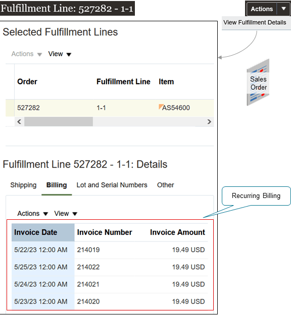

Examine Recurring Billing
You can examine recurring billing on the order line.
Try it.
- Open a sales order that includes recurring billing, and that you already submitted.
- On the Order page, click Actions > Switch to Fulfillment View.
- On the Fulfillment Lines tab, click a link in the Fulfillment Line attribute, such as 1-1.
- On the Fulfillment Line page, click Actions > View Fulfillment Details.
- In the dialog that displays, click Billing, then examine the recurring billing.
