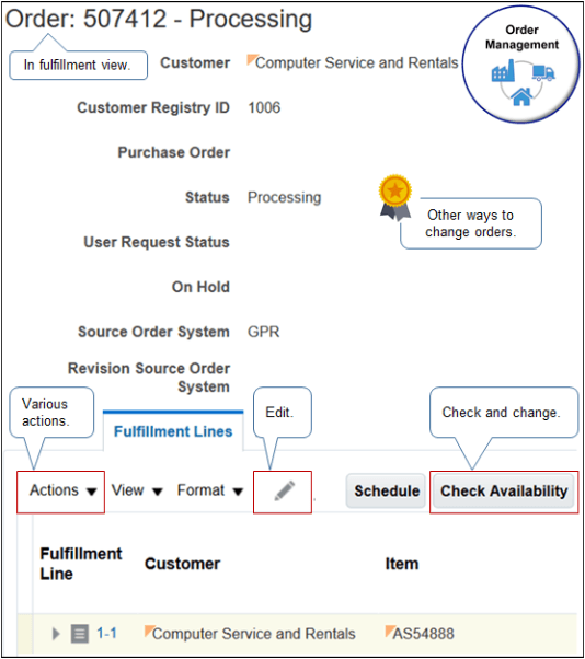

Go to the Order Management work area, then click Actions > Switch to Fulfillment View.
Click Actions, then click an action.
Split Fulfillment Line
Substitute Item
Remove from Shipment Set
Click Edit, then edit the order line.
For example, override a scheduling attribute.
Click Check Availability, then edit order line attributes.
These changes don't create an order revision, and Order Management doesn't create a revision number of the sales order.
Order Management constrains and compensates in the same way it constrains and compensates an order revision.
