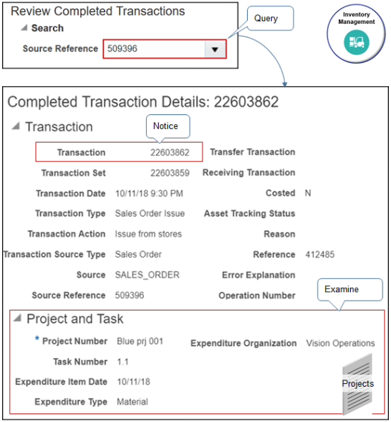

Click Cancel, then, on the Inventory Management page, click Tasks > Show Tasks > Inventory > Review Completed Transactions.
Search the Source Reference attribute for the sales order number, then examine project details in the Project and Task area.
Note
Inventory Management processes the issue inventory transaction for the sales order, then sends project cost details to Cost Management.
Cost Management charges the project for the shipped items.
Notice the value in the Transaction attribute is 22603862. You will use it next.

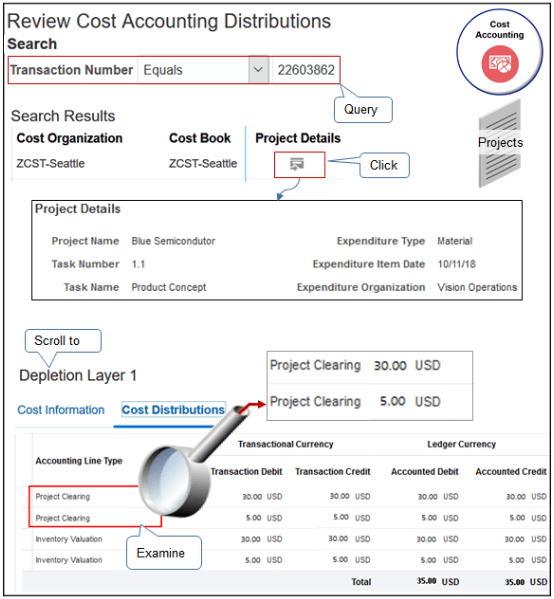

Examine Accounting
Use the Cost Accounting work area to examine accounting for your project.
Sign in with a privilege you can use to access Cost Accounting.
Go to the Cost Accounting work area.
On the Cost Accounting page, click Tasks > Review Cost Accounting Distributions.
On the Review Cost Accounting Distributions page, click Advanced, then query the Transaction Number attribute for 22603862, which is the value you noted earlier.
In the search results, click the icon in the Project Details column, then review your details.
Scroll down to the Depletion Layer area, then click Cost Distributions.
Examine the attribute.
Attribute
Value
Accounting Line Type
Project Clearing
Cost Accounting sets the Accounting Line Type attribute to Project Clearing so it can send project cost details to Project Costing.
Project Costing charges the project for the shipped items.
Examine values on the Project Clearing rows, such as.
Transaction Debt
Transaction Credit
Accounted Debt
Accounted Credit
Cost Element Type
