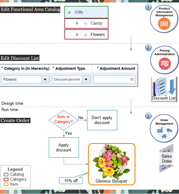

Note
- Assume you use the Product Information Management work area to create a Gifts catalog, and it contains a child Candy category and a child Flowers category. Each child contains items. For example, Flowers contains the Glorious Bouquet item.
- You use the Pricing Administration work area to create a rule that applies a discount for each item that's in the Flowers category.
- At run time, you create a sales order in the Order Management work area, and Pricing applies your rule depending on whether the item is in the Flowers category. The Glorious Bouquet is in the Flowers category, so Pricing applies the 15% discount.
Including and excluding provides you with more flexibility when you apply price adjustments. Assume you have 10 items that are in the Flowers category, including the Glorious Bouquet and the California Poppy. You want to apply a 15% on all 10 items except you don't want to apply that discount on the California Poppy. You can create a rule that applies a discount on all items that are in the Flowers category. You can create another rule that excludes the California Poppy.

Assume you need to set up this rule:
If the item is the Glorious Bouquet, and if the item is in the
Flowers category of the Gifts catalog, then apply a 15%
discount.
Here's a summary of your setup:
Note
- Set up the category's hierarchy and assign the item to the category.
- Manage the matrix class and discount list.
- Test your work.
This setup uses example values. You might need different values, depending on your business requirements:

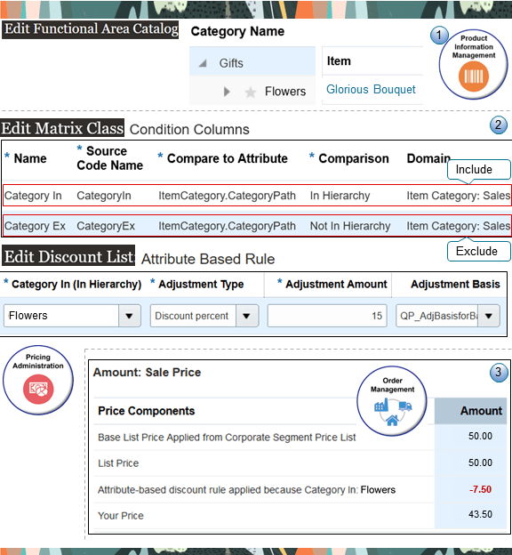

Manage Catalog
- Sign in with the privileges that you need to manage products.
- Go to the Product Information Management work area, then click Tasks > Manage Catalogs.
- On the Manage Catalogs page, click Create.
- In the dialog, set the values.
Attribute Value Functional Area Order Entry
You can select any area.
Catalog Name Gifts Catalog Code Gifts Description My gift catalog Controlled At Master Level
You can select any level.
Category Name Flowers Category Code Flowers Description My default category - Click Save and Continue.
- On the Edit Functional Area Catalog page, under Category Name, expand Gifts, then click Flowers.
- In the Details area, click Select and Add.
- In the dialog, search for the Glorious Bouquet item, then click Apply > OK.
- Run the Refresh Product Hub Snapshots scheduled process.
- Sign out, then sign in with the privileges that you need to administer Oracle Order Management.
- Go to the Setup and Maintenance work area, then go to the task:
- Offering: Order Management
- Functional Area: Pricing
- Task: Manage Pricing Parameters
- On the Manage Pricing Parameters page, click the row that has Product Catalogs in the Name column.
- In the Product Catalogs area, click Add Row, add the Gifts catalog, then click Save and Close.
Manage the Matrix Class
- Sign out, then sign in with the privileges that you need to administer pricing.
- Go to the Pricing Administration work area, then click Tasks > Manage Matrix Classes.
- On the Manage Matrix Classes page, click Pricing Term Adjustment.
- On the Edit Matrix Class page, create the condition that you'll use to include
the item in the adjustment.
- in the Condition Columns area, click Actions > Add
Row, then set the values.
Attribute Value Name Category In Source Code Name CategoryIn Comparison In Hierarchy Compare to Attribute ItemCategory.CategoryPath - Click Save.
- In the Domain column, click the pencil, set the
values, then click OK.
Attribute Value Domain Type Item Category Catalog Gifts - Click Save.
- While we're here, let's go ahead and add a condition that you can use to exclude
the item. We'll talk about excluding later.
- In the Condition Columns area, click Actions > Add
Attribute Value Name Category Ex Source Code Name CategoryEx Comparison Not In Hierarchy Compare to Attribute ItemCategory.CategoryPath - In the Domain column, click the pencil, set the
Attribute Value Domain Type Item Category Catalog Gifts - Click Save and Close.
Create Your Rule
- Click Tasks > Manage Discount Lists, then search for and open the list that you want to use.
- Add the Glorious Bouquet item to your discount list, then click Save.
- On the Edit Discount Lists page, in the Discount Rules area, click Actions > Create > Attribute Based Rule.
- In the dialog that displays, under Select Optional Condition Columns, add a check mark to Category In (In Hierarchy), then click OK.
- In the Create Discount Rule dialog, in the Attribute Based Rule area, click
Actions > Add Row, set the values, then click
OK.
Attribute Value Category In Flowers Adjustment Type Discount Percent Adjustment Amount 15 Adjustment Basis QP_AdjBasisforBaseListPrc - Click Access Sets, then set the value.
Attribute Value Set Code Vision Operations
For this example, assume you're selling in the Vision Operations business unit.
- Click Approve > Save and Close.
- Add your discount list to the pricing strategy that you use to price this item.
Test Your Work
- Go to the Order Management work area.
- Create a sales order.
Attribute Value Business Unit Vision Operations Order Type Standard Orders - Search for the Glorious Bouquet item on the catalog line, then click the price.
- Examine the price breakdown in the Amount dialog. Verify that the breakdown
says:
Attribute-based discount rule applied because Category In: Flowers In Hierarchy Flowers

You can set up your rule so it excludes items that are in a category. Assume you have this hierarchy:
Gifts
Candy
Flowers
Bouquets
Glorious Bouquet
Stems
California Poppy
Assume you need this rule:
Apply a 15% discount on the Glorious Bouquet item, but don't apply a discount
on the California Poppy item.
Set these values on your discount rule:
| Attribute | Value |
| Category Ex | Stems |
| Category In | Bouquets |
| Adjustment Type | Discount Percent |
| Adjustment Amount | 15 |
At run time, Pricing will apply the discount for the Glorious Bouquet, and the price breakdown will say:
Attribute-based discount rule applied because Category In: Bouquets In
Hierarchy Flowers Category Ex: Bouquets No In Hierarchy Stems
The price breakdown won't have a discount for the California Poppy.
