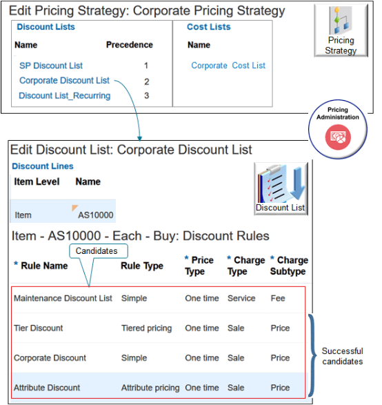

Assume your set up uses the Corporate Pricing Strategy.
Note
  • The Corporate Pricing Strategy contains three discount lists.
  • The Precedence for Corporate Discount List is 2.
  • Corporate Discount List contains rules for the AS10000 item.
    • There are two simple rules, a tier rule, and an attribute rule.
    • Each rule uses a Sale charge type and Price subtype except Maintenance Discount List, which uses Service and Fee.
  • None of the other lists contain rules for the AS10000.

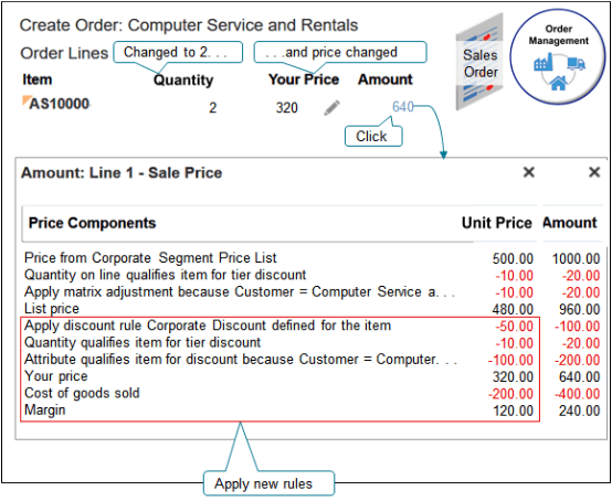

Now, change the quantity from 1 to 2 and see what happens.
Note
  • Your Price equals List Price minus the sum of the three new discounts.
    320 = 480 - (50 + 10 + 100)
  • The price breakdown displays the Cost Amount as Cost of Goods Sold.
  • Margin equals Your Price minus Cost of Goods Sold.
    120 = 320 - 200

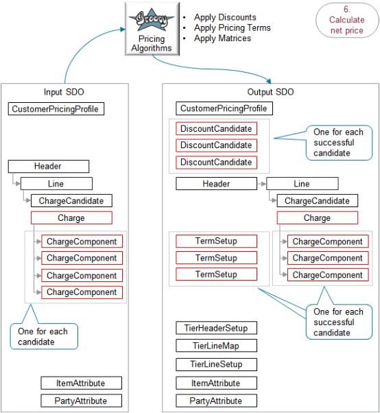

Here are the SDOs.
Note
  • The Calculate Net Price step provides the input SDO.
  • The Line entity in the input SDO represents one order line of a sales order.
  • The input SDO includes four ChargeComponent entities, one for each of the discount list candidates.
  • The algorithm creates entities for each successful pricing candidate in the output SDO. There are three successful candidates, so the SDO includes three DiscountCandidate entities, three TermSetup entities, and three ChargeComponent entities.
  • The service mapping works the same way as described earlier in this topic. The diagram doesn't include it for brevity.

1. Get discount candidates.
Examine the discount rules that are currently active on the pricing strategy. Examine them sequentially according to the value of the Precedence attribute for the list on the strategy. Stop when we find the first list that contains a successful candidate.
All active discount rules on the strategy are candidates.
In our example, the precedence for Corporate Discount List is 2, so the algorithm examines the rules on SP Discount List first, then Corporate Discount List.
Identify the successful discount rule candidates. To be successful, the discount list must.
  • Contain the same item that the order line contains, such as AS10000.
  • Contain the same unit of measure that the order line contains, such as Each.
  • The access set on the discount list must match the business unit on the order header.
In our example, SP Discount List has a precedence of 1, so the algorithm examines it first. It doesn't find a candidate, so it examines Corporate Discount List. It finds at least one candidate so it doesn't examine any other lists, such as Discount List Recurring.
All four rules in Corporate Discount List meet the criteria, so they're all successful candidates.
2. Qualify charge criteria.
Qualify the rule for each successful candidate.
The input SDO specifies.
ChargeSubtypeCode: ORA_PRICE
ChargeTypeCode: ORA_SALE
So, the algorithm filters out the Maintenance Discount List rule because its charge type is Service, not Sale, and its subtype is Fee, not Price.
At this point, only three discount candidates remain.

9. Apply simple adjustments.
Create a chargeComponent entity for each TermQueue that references a simple discount rule. Store the chargeComponent in the Charge entity in the output SDO.
In our example, the Corporate Discount rule is the only simple rule that matches the criteria. Assume the rule applies a $50 discount.
Calculate the running unit price: 480 minus 50 equals 430.
10. Apply other adjustments.
11. Apply tiered adjustments.
Create a chargeComponent entity for each TermQueue that references a tier discount rule. Store the chargeComponent in the Charge entity in the output SDO.
In our example, the Tier Discount rule is the only tier rule that matches the criteria. Assume the rule applies a $10 discount.
Calculate the running unit price: 430 minus 10 equals 420.
12. Apply matrix adjustments.
Create a chargeComponent entity for each TermQueue that references an attribute discount rule. Store the chargeComponent in the Charge entity in the output SDO.
In our example, the Attribute Discount rule is the only attribute rule that matches the criteria. Assume the rule applies a $100 discount.
Calculate the running unit price: 420 minus 100 equals 320.

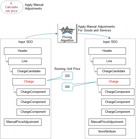

Apply Manual Price Adjustments

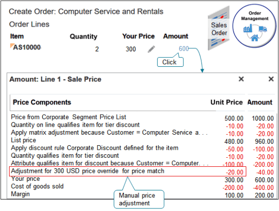

What happens when you apply a manual price adjustment?

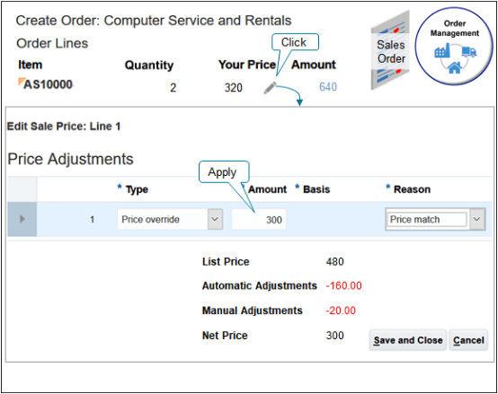

Assume your competitor offers a similar product, so you apply a manual price adjustment to match that price.
Note
  • You click the pencil in the Your Price column.
  • You use the Price Adjustments dialog to specify the manual price adjustment.
  • You apply a $300 price override.
Examine the breakdown.
Note
  • The override is 300, Your Price before the adjustment was 320, so the algorithm does a minus 20 adjustment.
  • Your Price equals List Price minus the sum of the four discounts.
    300 = 480 - (50 + 10 + 100 + 20)
    100 = 300 - 200

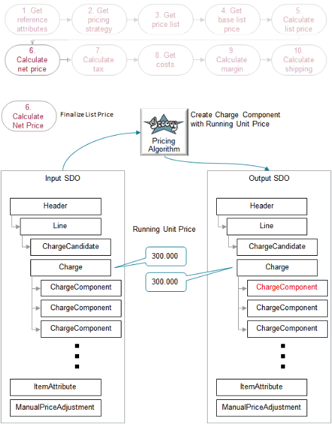

Here are the SDOs.
Note
  • The output SDO from the Apply Discounts from Pricing Strategy step provides the input SDO.
  • The ManualPriceAdjustment entity contains the values you set in the Price Adjustments dialog when you modify the sales order in the Order Management work area.
  • Use the Apply Manual Adjustments For Goods and Services algorithm.
  • The running unit price for the charge on the input SDO after applying discounts from the pricing strategy but before applying the manual adjustment is $320.
  • The running unit price for the charge on the output SDO after applying the manual adjustment is $300.
  • The algorithm uses the ManualPriceAdjustment entity to apply the sales price charge on the line.
  • The algorithm uses your set ups in the Pricing Administration work area.
Here's what the algorithm does.
What the Algorithm Does
How the Algorithm Does It
Validate manual price adjustments.
Makes sure.
  • There's a matching charge.
  • Pricing can manually adjust the charge.
  • Pricing supports the manual adjustment type.
  • Pricing can determine the rate for the currency conversion.
  • The currency type supports a manual price adjustment according to amount.

Calculate manual adjustments for rolled up charges.
Calculate manual adjustments for native charges.
Here are details about attributes in the SDOs.
Entity
Attributes in Input SDO
Attributes in Output SDO
AdjustmentCurrencyCode: USD
AdjustmentTypeCode: PRICE_OVERRIdE
AdjustmentValue: 300
ChargeDefinitionId: 3001000070841552
ChargeParentEntityCode: LINE
ChargeParentEntityId: 1
ChargeRollupFlag: N
Adjustment Type Code identifies the value you select for the Type attribute in the Price Adjustments dialog.
Adjustment Value identifies the value that you enter in the Amount attribute in the Price Adjustments dialog.
ChargeComponent
ChargeComponentId: 8
ChargeId: 1
CurrencyCode: USD
ExtendedAmount: -40 USD
PriceElementCode: QP_CUSTOM_ADJUSTMENT
PriceElementUsageCode: PRICE_ADJUSTMENT
PriceValidFrom: 2019-06-03 @ 21:58:27
SequenceNumber: 1007
SourceId: 0
SourceTypeCode: MANUAL_ADJUSTMENT
UnitPrice: -20 USD
Unit Price is the amount of adjustment needed to bring the net price to the value that you enter for the Adjustment Value after Pricing subtracts the automatic adjustments.
In this example, automatic adjustments are the sum of the discounts that the algorithm calculated. Recall the equation we used before you applied the manual adjustment.
So, if Your Price is 320, and if you enter 300 as a price override for the manual adjustment, then we need to subtract another 20 from 320 to get to the Net Price of 300.
There's a quantity of 2 on the order line, so Extended Amount equals manual adjustment 20 multiplied by Quantity 2 equals $40.
Here's a function you can use with the Apply Manual Adjustments For Goods and Services algorithm.

Get the Invoice Price
Next, we calculate the invoice price.
Note
  • You use the Create Charge Component with Running Unit Price algorithm. For details, see the Finalize List Price section earlier in this topic.
  • If you create a rounding rule for the currency that the charge references, then the algorithm rounds according to the rule.
  • The running unit price in the input SDO is 300.000.
  • The running unit price in the input SDO is also 300.000. No rounding happens in this example.
1. Get the rounding rules.
2. Round.
Round the net price according to the rounding rules. Assume the rules in the example round to the nearest hundredth.
3. Calculate.
Calculate the difference between the rounded value and the value that the algorithm hasn't rounded, then store the difference as a rounding adjustment.
Assume you create a rule that rounds to decimal precision two, or hundredth. If the input SDO contained 300.473, then the rounded value would be 300.47, and the adjustment for the net price is 47 cents.
Here are details about entities in the SDOs.
Entity
ChargeComponent
ChargeComponentId: 9
ChargeId: 1
CurrencyCode: USD
ExtendedAmount: 600 USD
PriceElementCode: QP_NET_PRICE
PriceElementUsageCode: NET_PRICE
SequenceNumber: 1008
SkipRunningPrice: Y
TaxIncludedFlag: N
UnitPrice: 300.00 USD
