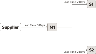

These are the details of the supply chain:
- The source location is M1 and gets its supply from a supplier.
- The lead time for M1 is 3 days. The lead time is considered as a
constraint.
However, the supplier capacity isn't considered as a constraint.
- M1 has two destination locations named S1 and S2.
The lead time for S1 and S2 is 2 days.
- The applicable policy type is min-max planning.
The following figure depicts this supply chain:
As is evident from the example, the logic for recommending unconstrained planned orders in multiechelon replenishment planning is the same as the logic for recommending planned orders in a replenishment plan that doesn't use the functionality for multiechelon replenishment planning.
