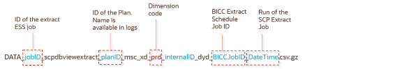

Dimension file name patterns
Dimension data file:
Dimension definition file:
Dimension file name parts
Description
jobID
The job ID of the extract scheduled process.
planID
The ID of the plan. This name is available in log files.
Dimension code
The dimension code that the hierarchies in the file belong to. Used in the dimension data file, but not the dimension definition file.
BICCJobID
The job ID of the extract scheduled job of the BI Cloud Connector (BICC) tool.
DateTime
Date and time the extract scheduled process began.

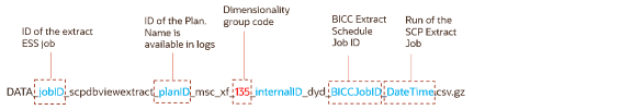

Measure file name patterns
Measure data file:
Measure definition file:
Measure file name parts
Description
jobID
planID
Dimensionality group code
Name of the dimensionality group code. Used in the measure data file, but not the measure definition file.
BICCJobID
DateTime
