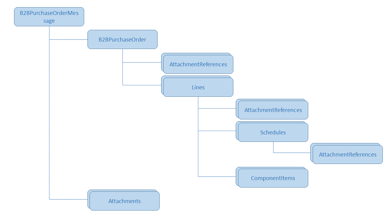

Oracle 1.0 B2B Purchase Order In
Figure 1 shows the structure of the payload that's received from the customer for the predefined message definition Oracle-1-0-B2B-Purchase-Order-In.
Figure 1
Payload structure for the message definition Oracle 1.0 B2B Purchase Order In.

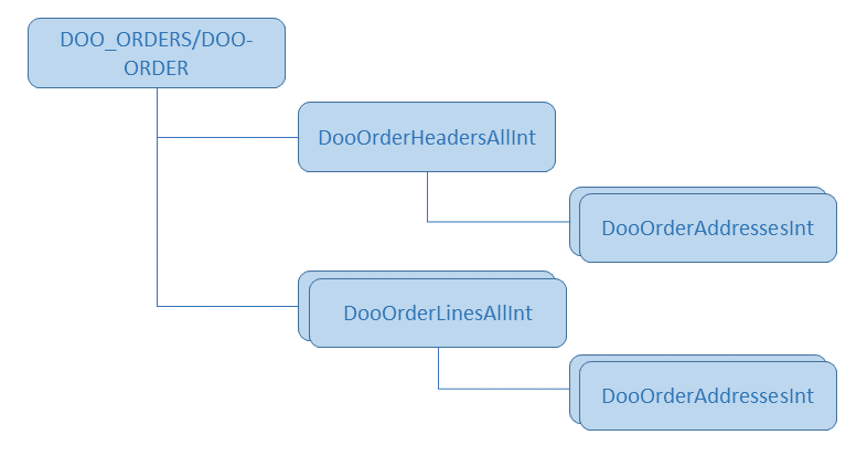

Figure 2 shows the structure of the transformed payload that is sent to the application for the predefined message definition Oracle-1-0-B2B-Purchase-Order-In.
Figure 2
Transformed payload structure for the message definition Oracle 1.0 B2B Purchase Order In.
