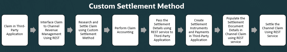

This image shows the workflow for using customer settlement methods.
