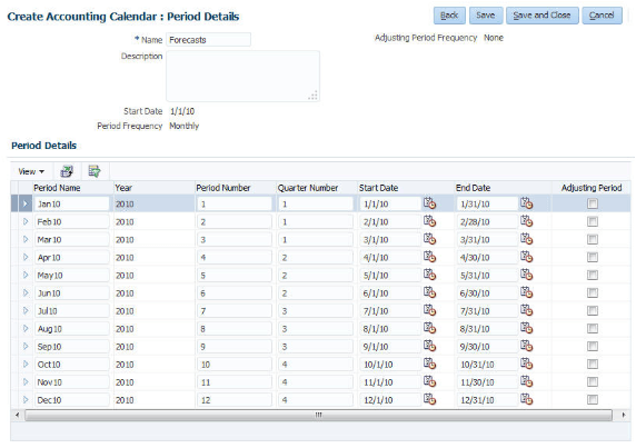

  4. Click Next. The Create Accounting Calendar: Period Details page appears, showing the generated periods. The image shows multiple columns, including:
    • Period name, which is month name, one for each month of the year
    • Year, which is 2010
    • Period number, one for each month
    • Quarter number for each period, assuming four quarters in the year
    • Start and end dates for the periods
    • A check box used to indicate whether a period is an adjusting period
    Here's an example of the Create Accounting Calendar: Period Details page:
    The Period Details page shows the calendar periods for the first year.
