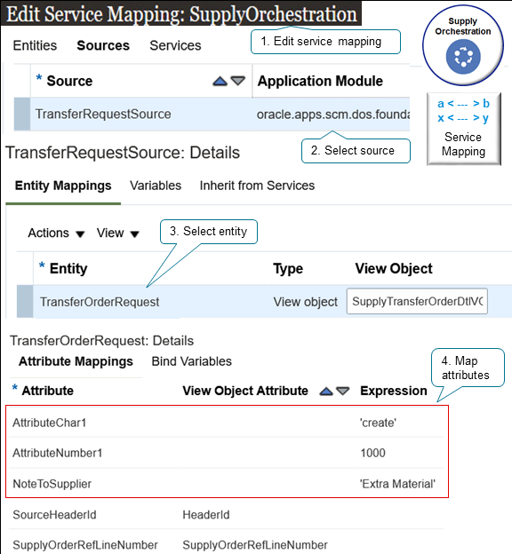

For example, create a service mapping that uses the TransferOrderRequest entity in the TransferRequestSource service.
The service sends a request to create a transfer order from Supply Chain Orchestration to Inventory Management:
  1. Edit the SupplyOrchestration service mapping.
  2. Select the TransferRequestSource source.
  3. Select the TransferOrderRequest entity.
  4. Map your attributes. For example:
    Attribute Expression
    AttributeChar1 'create'
    AttributeNumber1 1000
    NotetoSupplier 'Extra Material'
