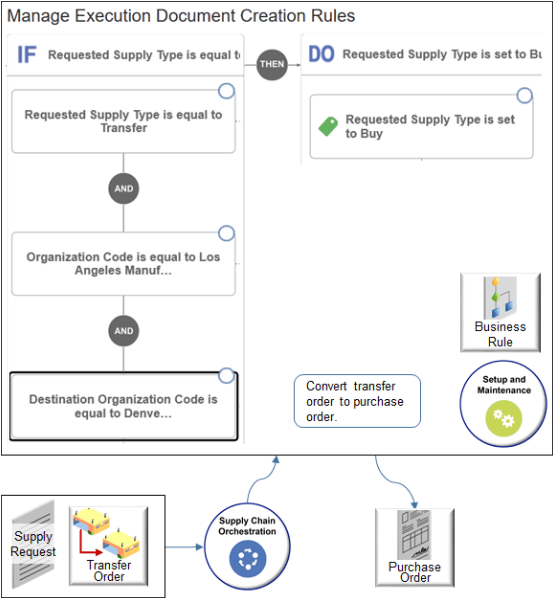

Assume you work for Vision Corporation. Vision creates a new factory in Denver to meet an increase in demand. Your main factory is in Los Angeles. You must transfer material from Los Angeles to Denver, but Denver is an independent profit center in Vision, so you need a rule that converts the transfer order to a purchase order.
If the Requested Supply Type attribute equals Transfer, and if the Organization Code attribute equals Los Angeles, and if the Destination Organization Code attribute equals Denver, then set Requested Supply Type to Buy.
Here's your rule.
      Do it.

On the Manage Execution Document Creation Rules page.
Attribute
Value
Name
Create Supply for Denver
Description
If moving items from Los Angeles to Denver, then convert transfer order to purchase order.
Add the If statement and Do statement.
