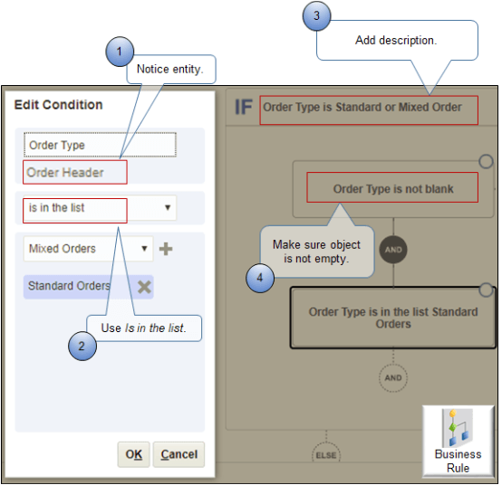

  1. Notice the entity. You enter the attribute, such as Order Type, and then the entity that contains the attribute, such as Order Header, displays immediately under the attribute.
    Most attributes on the order header are different from attributes on the order line. For example, the order header includes the Order Type attribute but the order line doesn't. However, the order header and the order line contain similar or identical attributes. For example, the order header and the order line each include attribute Shipping Instruction. If your rule must reference Shipping Instruction on the order header, then make sure you use the order header entity.
  2. Is in the List. Use Is in the List to examine the list of values that the attribute references instead of writing an OR condition. For example, the list of values for Order Type includes Mixed Orders and Standard Orders. If you don't use Is in the List, then it might be necessary to write a series of OR conditions. For example:
    If Order Type equals Mixed Orders, or If Order Type equals Standard Orders
  3. Add the description. Description for the IF statement is optional. However, you can use it to quickly scan your rule logic without having to drill down into the rule to determine the purpose of the statement. You can also add a description for the Then clause.

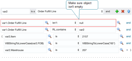

  4. Make sure the object isn't empty.
    If your rule depends on a value, and if the rule references an attribute that doesn't contain a value, then it might fail with unpredictable results, such as an error. For example:
    Manage Process Assignment Rules for Sales OrdersView row with key oracle.jbo.Key[null ] is not found in __DimensionVO__For__Reference__For_DCL__
    Avoid this problem. Make sure the value of any attribute that your rule references isn't empty.
    Here's an example of how to do it in Oracle Business Rules:
    example of how to do it in Oracle Business Rules.

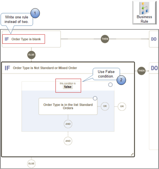

  1. Structure your rule:
    • Put all your logic in one rule instead of spreading it across more than one rule.
    • Write one rule that includes more than one IF_THEN_ELSE statement instead of writing more than one rule.
    • Add an IF THEN ELSE structure.
    • Nest your rules, such as adding another IF after an ELSE.
  2. To look for values that aren't in the list, write a rule that looks for values in the list, then add a False condition. Use False directly in the IF statement to implement a NOT condition rather than adding another rule.

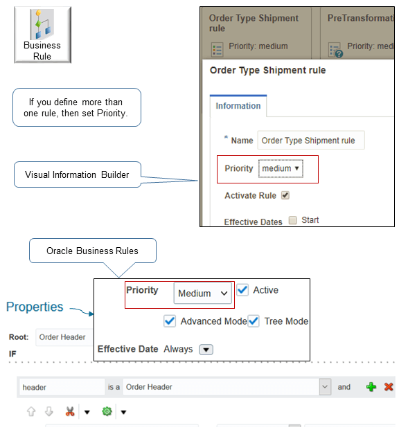

Set the Priority
If you set up more than one rule to meet the same business requirement, then set the priority:
Writing More Than One Rule
The priority determines the sequence that Order Management uses when it applies the rule. Assume you set priority to Medium for rule x and to High for rule y. Assume the conditions in the If statements in rules x and y evaluate to true. Order Management will apply rule y on the orchestration process first, and then will apply rule x.

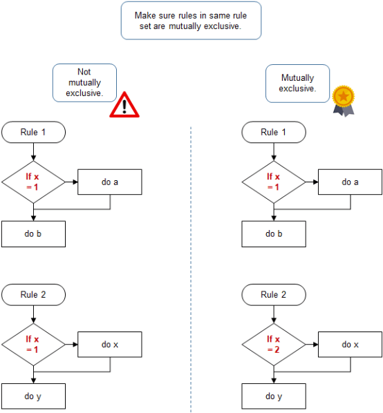

Make Sure Rules Are Mutually Exclusive
Make sure the rules in a single rule set are mutually exclusive:
Make sure the rules in a single rule set are mutually exclusive.
A rule set is a group of rules that run together to achieve a business objective. For example, assume you create a pause rule and a release rule on a pause task. The pause rule and release rule together constitute one rule set. Oracle Business Rules runs all the rules in a rule set. To avoid logic problems, make sure no two rules can be true at the same time, or false at the same time.
