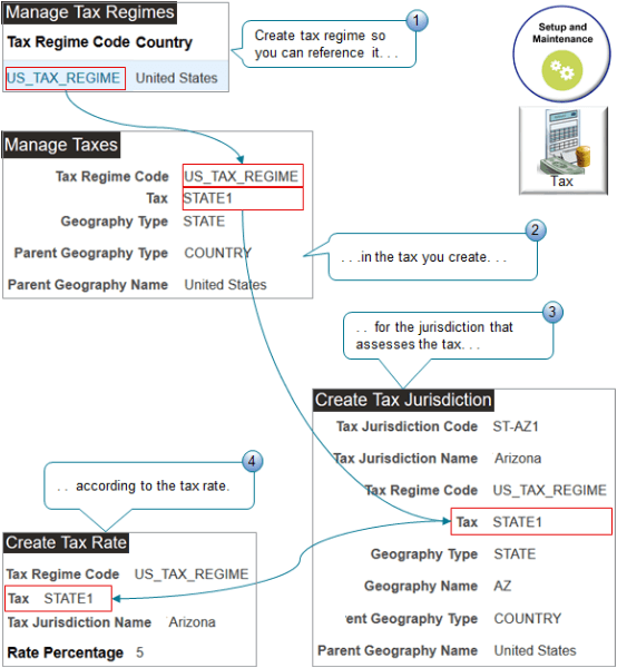

Here's the flow that you use to set up the example in this topic:
Here are the tasks you use:
Task
Description
1. Manage Tax Regimes
Create a tax regime named USA_TAX_REGIME for the United States.
2. Manage Taxes
Create a tax named STATE1 at the state level for Arizona.
3. Create Tax Jurisdiction
Create a tax jurisdiction for the state of Arizona.
4. Create Tax Rate
Create the 5% tax rate to apply for the STATE1 tax.
Each task maintains the tax hierarchy. For example:
  • The tax rate is in the USA_TAX_REGIME and the Arizona jurisdiction.
  • The Arizona jurisdiction and the STATE1 tax are in the USA_TAX_REGIME.

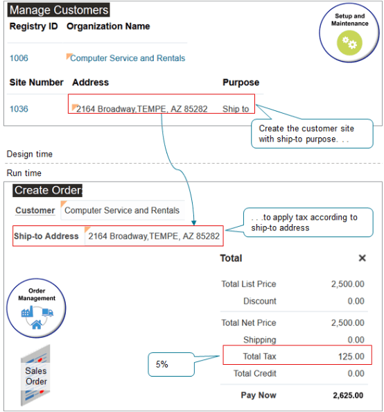

Add the Customer Site
Use the Manage Customers task to create a site for your Computer Service and Rentals customer. You specify the purpose as ship-to so you can use the ship-to address on the sales order to determine the tax to apply:
Try it.
  1. On the setup page, go to the Manage Customers task.
  2. On the Manage Customers page, search for the value:
    Attribute
    Value
    Organization Name
  3. In the search results, in the Sites area, click Actions > Create.
  4. On the Create Account Site page, set the values:
    Attribute
    Value
    Account Address Set
    Vision Operations Set
    Country
    United States
    Site Number
    1036
    Address Line 1
    2164 Broadway
    City
    TEMPE
    State
    AZ
    Postal Code
    85282
  5. In the Address Purposes area, click Actions > Add Row, set the values, then click Save and Close > Done:
    Attribute
    Value
    Purpose
    Ship To

Test Your Set Up
  1. Go to the Order Management work area and create a sales order:
    Attribute
    Value
    Customer
    Business Unit
    Vision Operations
    Ship-to Address
    2164 Broadway, Tempe, AZ, 85282
  2. Add an order line:
    Attribute
    Value
    Item
    AS54888
    Quantity
    1
    Amount
    2,500
  3. Click the total at the top of the sales order, then verify that the tax rate is 5%, which is the STD-DEFAULT rate you set up according to the ship-to address:
    Attribute
    Value
    Total List Price
    2,500.00
    Discount
    0.00
    Total Net Price
    2,500.00
    Shipping
    0.00
    Total Tax
    125.00
    125 is 5% of 2,500, so this rate is correct.
    Total Credit
    0.00
    Pay Now
    2,625.00
  4. Change the ship-to address to any other value.
  5. Click the total at the top of the sales order, then verify that the tax rate is 10%, which is the STD rate you set up to apply when the ship-to address isn't 2164 Broadway, Tempe, AZ, 85282:
    Attribute
    Value
    Total List Price
    2,500.00
    Discount
    0.00
    Total Net Price
    2,500.00
    Shipping
    0.00
    Total Tax
    250.00
    250 is 10% of 2,500, so this rate is correct.
    Total Credit
    0.00
    Pay Now
    2,750.00
