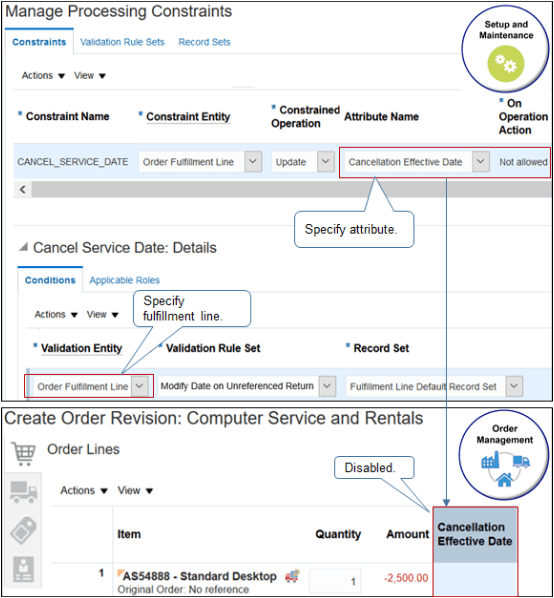

Constrain Return Orders
Set up a processing constraint that constrains changes the Order Entry Specialist makes to a return that doesn't reference the original sales order.
For example, Order Management uses the Cancellation Effective Date attribute to price a return that doesn't reference the original order. Here's your constraint:
  • If the return doesn't reference the original sales order, then don't allow you to modify Cancellation Effective Date.
Here's your set up:
Setup flow to constrain returns without original sales order.
For details, see Manage Processing Constraints.
Use an order management extension to implement a more specialized constraint. For example, if its been 15 days or more since Order Management sent the sales order to invoicing, then write an extension that prevents you from creating a return material authorization. Use the On Save extension point. For details, see Points Where You Can Run Order Management Extensions.
This topic uses example values. You might need different values, depending on your business requirements.
Try it.
  1. Go to the Setup and Maintenance work area, then go to the Manage Processing Constraints task.
  2. Add the validation rule set:
    • On the Manage Processing Constraints page, click Validation Rule Set, then add a rule set:
      Attribute
      Value
      Attribute
      Value
      Name
      Modify Date on Unreferenced Return
      Description
      If the return doesn't reference the original sales order, then don't allow user to modify date.
      Short Name
      UNREF
      Validation Type
      Table
      Entity
      Order Fulfillment Line
    • In the Details area, click Actions > Add Row, set the values, then click Save:
      Attribute
      Value
      Name
      Validation Operation
      Is Not Null
    • Click Generate Packages, notice the Confirmation dialog displays your request ID, then wait a few minutes for the request to finish.
      For example:
      The concurrent request to generate constraints validation packages was submitted. Request ID: 10650.
  3. Add the constraint:
    • Click Constraints > Actions > Add Row, then set the values:
      Attribute
      Value
      Constraint Name
      CANCEL_SERVICE_DATE
      Display Name
      Cancel Service Date
      Constraint Entity
      Constrained Operation
      Update
      Attribute Name
      Enabled
      Contains a check mark
    • In the Conditions area, add the condition:
      Attribute
      Value
      Group Number
      1
      Validation Entity
      Validation Rule Set
      Don't allow date change on unreferenced return
      Scope
      Any
      Record Set
      Fulfillment Line Default Record Set
      Message
      You must not modify Cancellation Effective Date when you return a sales order without the original order because Order Management uses this date to price the return.
    • Click Generate Packages and wait a few minutes.
Test Your Set Up
  1. Navigate to the Order Management work area and create a new sales order:
    Attribute
    Value
    Customer
    Computer Service and Rentals
    Business Unit
    Vision Operations
    Bill-to Account
    1006
  2. Click Actions > Create Unreferenced Return Lines on the order line, then set the values:
    Attribute
    Value
    Item
    Add a subscription that uses a fixed Service Duration Type. For details, see Set Up Coverages for Sales Orders.
    For this example, assume your implementation includes fixed subscription QP_SUBS_ITEM7-FIXED.
    Return Quantity
    1
    UOM
    Each
    Return Type
    Return for Credit and Return the Item
    Return Location
    Vision Operations
  3. Click Submit.
  4. If the order line status is Not Started, then wait a moment, and click Refresh. Repeat until status is Awaiting Receiving.
  5. Click Create Revision.
  6. On the order line, modify the value in Cancellation Effective Date, then click Submit.
