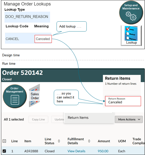

Create Return Reasons
Create a return reason so the Order Entry Specialist can select it when returning an order line.
Assume you need to add a reason you can select to indicate that the customer feels the description you have for the item on your website isn't accurate.
Summary of the Set Up

Create Lookup
  1. Go to the Setup and Maintenance work area, then go to the Manage Order Lookups task.
  2. On the Manage Order Lookups page, enter the value, then click Search:
    Attribute
    Value
    Lookup Type
    DOO_RETURN_REASON
  3. In the Lookup Codes area, click Actions > New then set the values:
    Attribute
    Value
    Lookup Code
    NOT_ACCURATE
    Display Sequence
    1
    Start Date
    The current date.
    End Date
    Leave empty.
    Meaning
    Item's Description Isn't Accurate
    Description
    The item's description on the website isn't accurate.
  4. Click Save and Close.

Test Your Set Up
  1. Go to the Order Management work area and search for a sales order:
    Attribute
    Value
    Status
    Closed
    You can only return a sales order that isn't open and that's closed, or an order line that Order Management has shipped but not closed.
  2. Open the sales order, select the order line you want to return, then click Enable Returns.
  3. Verify that you can set the value:
    Attribute
    Value
    Return Reason
