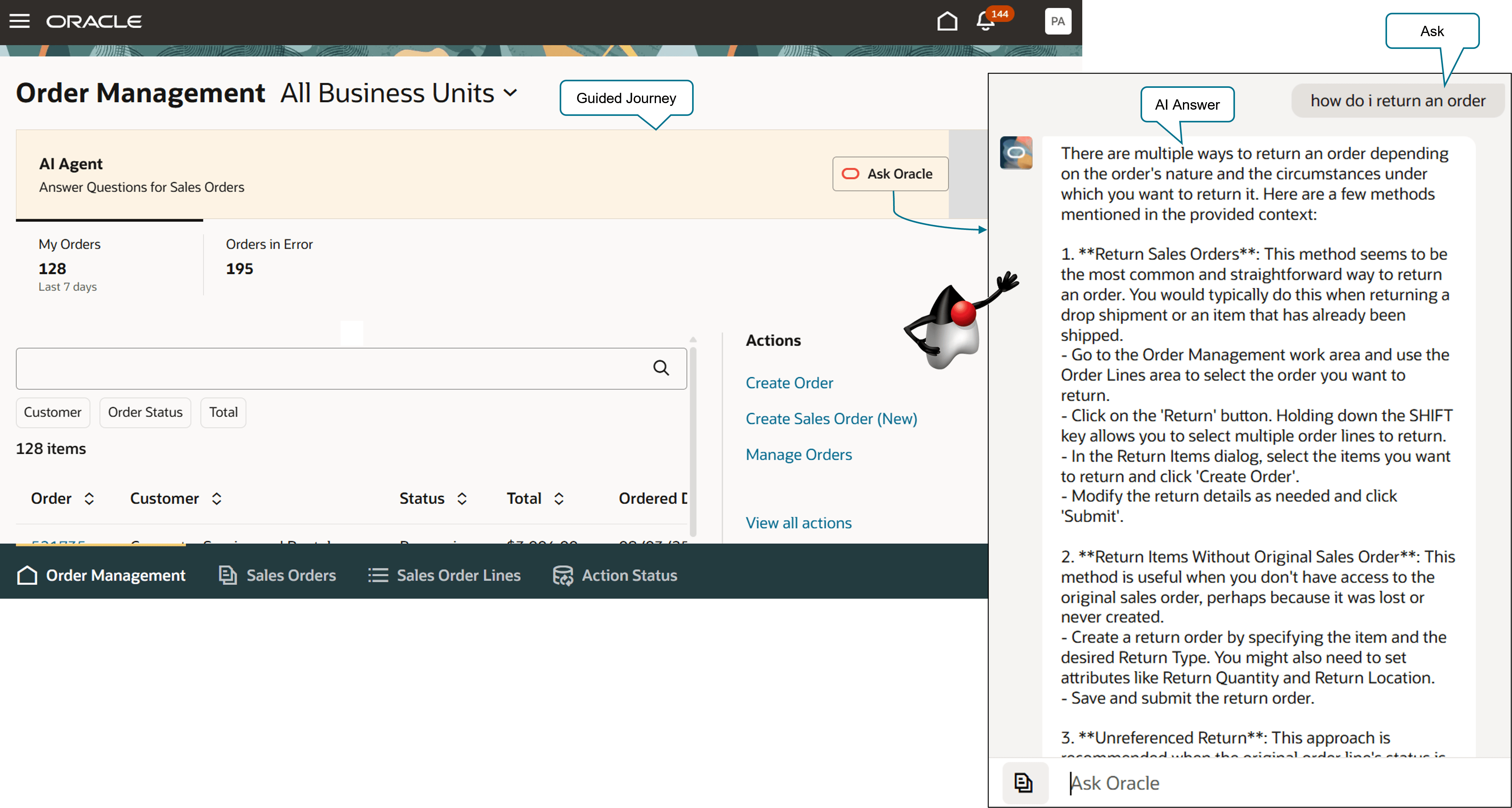

Add and Test Your Journey
You can display the agent by itself or in a guided journey. For this example, display it in a journey:
  1. Go to Home Page > My Client Groups > Show More > CTRL+F, search for, then click Guided Journey.
  2. On the Guided Journey page, click Create, set these values, then click Create Draft:
    Attribute Value
    Name Guided Journey for Order Management
    Code GUIDED_JOURNEY_FOR_ORDER_MANAGEMENT
  3. On the Guided Journey for Order Management page, add this task, then click Save > Activate:
    Attribute Value
    Task Name Sales Order Agent
    Task Description Answer Questions for Sales Orders
    Task Type Agent
    Agent Type RAG Agent
    Agent SCM_ORDER_MANAGEMENT_AGENT
    The Order Management work area will display the Task Name and Task Description on the journey's banner. We recommend that you use headline capitalization so it's consistent with the work area's style.
  4. Go to Home Page > Order Management > Show More > Sales Orders (New).
  5. Click Settings and Actions > Edit Page in Visual Builder Studio.
    The browser opens a new tab for Visual Builder Studio.
  6. In Visual Builder Studio, set the JourneyCode property to GUIDED_JOURNEY_FOR_ORDER_MANAGEMENT, then click Publish.
  7. Go back to the tab that has your list of sales orders, then right-click > Reload
    Notice that the page displays your new agent inside the guided journey's banner.
  8. Use the agent to ask various questions. Verify them against your source documents to make sure the answers are correct.
  9. Click the icon immediately to the left of the prompt on the guided journey, then select one of the sources that you uploaded. Ask the same question for different sources. Notice how the answer provides content only from the source that you select.
