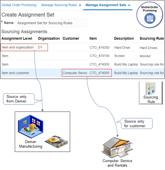

Add More Assignments
You can add more than one sourcing rule and assign them differently. Global Order Promising offers you a wide range of choices:
For example, assume you create three different sourcing rules and assign them differently according to item, organization, and customer:
  1. Assign the CTO_474000 Build My Laptop item, which is the model, to Sourcing rule for Build My Laptop.
  2. Assign the CTO_474000 to Sourcing rule for Build My Laptop only if the customer is Computer Service and Rentals.
  3. Assign the CTO_474300 Hard Drive, which is an option class, to the Hard Drives sourcing rule, which is a rule you set up that's optimized to source hard drives.
  4. Assign the CTO_474100 Screen, which is an option class, to the Monitor sourcing rule, which is a rule you set up that's optimized to source monitors. Source the CTO_474100 only from D1 Denver Manufacturing when running the sourcing rule.
If you add more than one assignment, then Global Order Promising considers the sourcing rule you set for the most detailed assignment level first. Here's a list of assignment levels that you can use, listed from least detailed to most detailed. For example, Region is more detailed than Global. If you add a global assignment and a regional assignment, then planning runs the regional assignment first, then the global assignment:
  • Global
  • Region
  • Demand class
  • Customer
  • Customer and customer site
  • Category
  • Category and region
  • Item
  • Category and demand class
  • Category and customer
  • Category and customer site
  • Item and region
  • Item and demand class
  • Item and customer
  • Item and customer site
For details, see Set Your Assignment Levels and
Consider Your Sourcing Hierarchy and Assignment Set Hierarchy.
