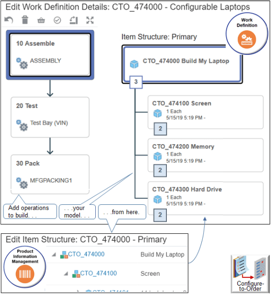

Create Work Definitions for Configured Items
Use the Work Definition work area to specify the operations you need to build the configuration model that you set up in the Product Management work area, and the resources that you need to do the operations.
For example, specify assemble, test, and pack operations for the CTO_474000 model:
For details, see Overview of Work Definitions.

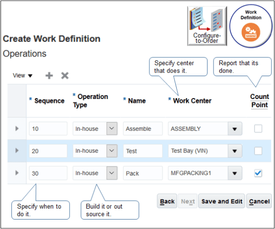

  3. Create the work definition:
    • Click Tasks > Manage Work Definitions.
    • On the Manage Work Definitions page, click Actions > Add.
    • In the Create Work Definition dialog, set the values, then click Next:
      Attribute
      Value
      Item
      CTO_474000
      Name
      Configurable Laptops
      Production Priority
      1
      Priority 1 specifies to use the primary work definition.
    • Click Add Row and set the values:
      Attribute
      Value
      Sequence
      10
      Operation Type
      In-house
      Name
      Assemble
      Work Center
      Assembly
      Attribute
      Value
      Sequence
      20
      Operation Type
      In-house
      Name
      Test
      Work Center
      Test Bay
    • Click Add Row, set the values, then click Save and Edit:
      Attribute
      Value
      Sequence
      30
      Operation Type
      In-house
      Name
      Pack
      Work Center
      MFGPACKING1
      Count Point
      Enabled
      Use this attribute to specify that the last step in the sequence is done.
      You must specify Count Point on the last step. You can also specify it on other steps to indicate activities that must finish for them.

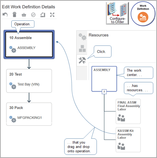

  1. On the Edit Work Definition Details page, in the area that displays the item structure, click Resources.
  2. Add resources to your first operation:
    • Click the Assemble operation.
    • Click the Kit Assembly Labor resource, drag it, then drop it onto the Assemble operation.
      Each work center has resources that do the operation. Your work center might use resources that are different than this example uses. Learn how to create a work center and it's resources. For details, see How You Manage Work Centers.

    • Click the Final Assembly Labor resource, drag it and drop it onto the Assemble operation, set the values in the dialog, then click OK.

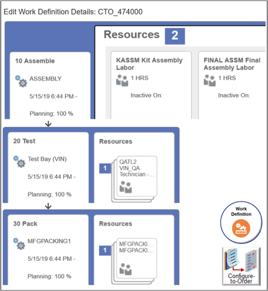

  3. Repeat step 2 for the Test operation.
  4. Repeat step 2 for the Pack operation.
Your set up should like something like this:

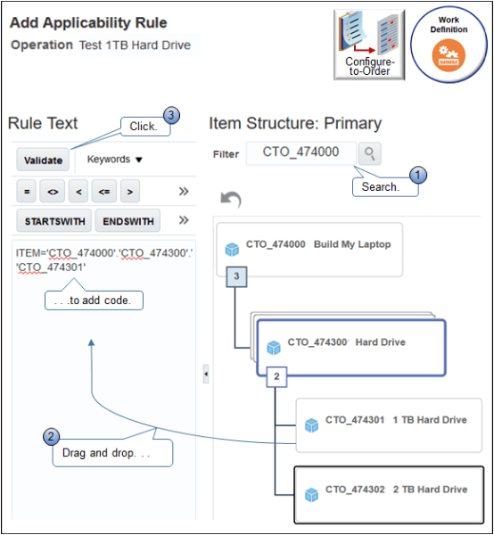

  4. Add a test for the 1 TB hard drive:
    • On the Edit Work Definition Details page, click the Test 1 TB Hard Drive operation, then click Actions > Edit.
    • In the Edit Operation dialog, add a check mark to Option Dependent.
    • Next to Applicability Rule, click Add.
    • In the Applicability Rule dialog, in the Item Structure area, click the CTO_474300 Hard Drive component.
    • Drag and drop the CTO_474301 1 TB Hard Drive option onto the Rule Text area.
      Notice the text area adds some code.
      ITEM='CTO_474000'.'CTO_474300'.'CTO_474301'
      CTO_474000 is the model, CTO_474300 is the option class for the hard drive, and CTO_474301 is the 1 TB hard drive.
      Here's the hierarchy the code uses.
      ITEM='model'.'option class'.'option'
    • Click Validate, then make sure the validation succeeds.
