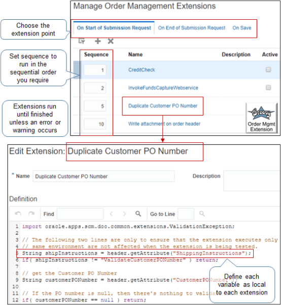

Consider Runtime Behavior
flow of the runtime behavior
Note
  • Order Management runs each extension in sequential order, and it only extensions where the Active attribute contains a check mark run. Assume you create extensions x, y, and z. Extension x runs first, then extension y. If you make z active, then Order Management runs extension x, and then z, and then y:
    Sequence
    Extension Name
    Active
    1
    x
    Contains a check mark
    10
    y
    5
    z
    Doesn't contain a check mark
  • Order Management runs each active extension until it finishes unless an error or warning happens. If an error or warning happens, then Order Management doesn't run any more extensions. For example, assume x, y, and z are active, x finishes, but z ends in error. Order Management won't run extension y.
  • Each variable is local to each extension. You can't share them across extensions. For example, assume you require variable A in extensions x and y. If you define variable A in x, then you can't use A in y. Instead, you must write logic in y that references A in x.
