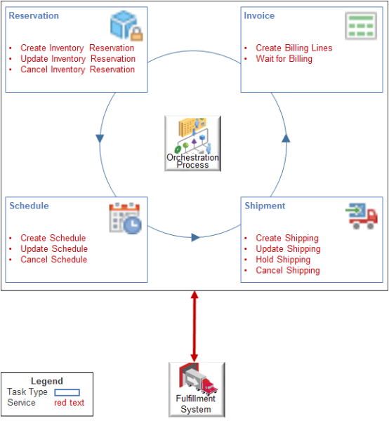

Here are some typical task types, the services they call, and the sequence that Order Management uses to run them. This example starts with a reservation:
typical task types, the services they call, and the sequence you use to run them.

  • Reservation is an example of a task type. It contains a set of services that communicate with your fulfillment system to reserve inventory according to the Item attribute and Quantity attribute of your order line. For example, it uses the Create Inventory Reservation service to reserve supply in inventory.
  • A typical sequence is to use services to reserve inventory for your item, schedule it for shipping, ship it, then invoice it:
    • Create Inventory Reservation
    • Create Schedule
    • Create Shipping
    • Create Billing Lines

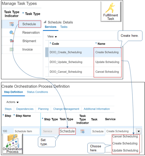

The Create Orchestration Process Definition page references the Manage Task Types page to get the values that it displays for the task, type task, and service that you can choose on each step:
The Create Orchestration Process Definition page references the Manage Task Types page to get the values it displays for the task, type task, and service that you can choose on each step.
In this example, the orchestration process references the Schedule task type, and it also references the Schedule task type's services.
