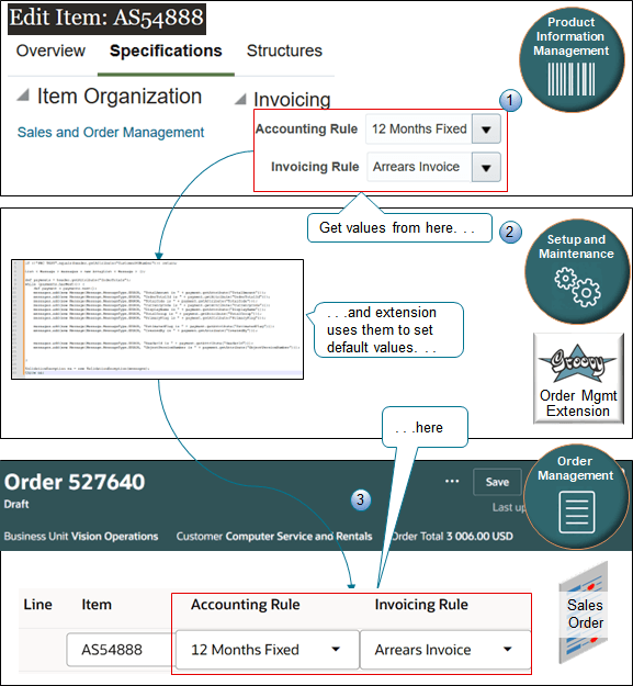

Create an order management extension that gets a value for your item from the Product Management work area, then use it to set the default value for an attribute on the sales order.
Here's an example of how it works:
Here's an example of how it works.
What the Numbers Mean
  1. Use the Product Management work area to set the values for the attributes you need to reference.
  2. Use the Setup and Maintenance work area to create an order management extension that gets the values from Product Management and uses them to set default values for attributes on the sales order in the Order Management work area.
  3. At run time, use the Order Management work area to create the sales order and Order Management automatically sets the attribute values.
Here's some example pseudocode for your extension.
If the Order Entry Specialist adds the AS54888 item to an order line, then set the default value for the Accounting Rule attribute on the order line to the same value that the Accounting Rule attribute contains for the item in Product Management, and set the value for the Invoicing Rule on the order line to the same value that the Invoicing Rule attribute contains for the item in Product Management.
This topic uses example values. You might need different values, depending on your business requirements.

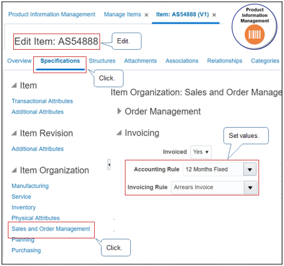

Modify the Item
Use the Product Management work area to modify the item.
Do it.
  1. Make sure you have the privileges that you need to administer Product Management.
    If you don't sign in with these privileges, then the Product Management work area won't display your product details and you can't do this procedure.
  2. Go to the Product Management work area.
  3. Click Tasks > Manage Items, then search for the value:
    Attribute
    Value
    Item
    AS54888
  4. In the search results, click AS54888.
  5. On the Edit Item page, click Specification > Sales and Order Management.
  6. In the Invoicing area, set the values, then click Save
    Attribute
    Value
    Accounting Rule
    12 Months Fixed
    Invoicing Rule
    Arrears Invoice
  7. Collect data. For details, see Collect Planning Data for Order Management.
