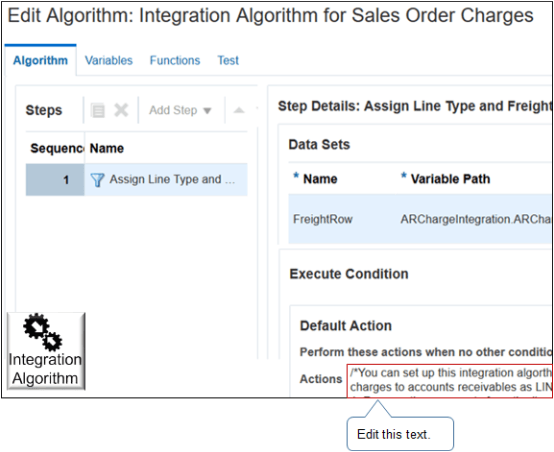

  5. On the Edit Algorithm page, in the Step Details area, in the Execute Condition area, in the Default Action area, locate the code in the Default Actions window:
    Editing the integration algorithm.
  6. Click Edit immediately to the right of the Actions window.
    Notice the text that Actions contains.
    /*You can set up this integration algorthim so it uses Oracle Receivables to calculate tax on the shipping charge. To do this, you must interface taxes and charges to Oracle Receivables as LINE and not as FREIGHT.  Do this:
    1. Remove the comments from the lines below.
    2. Publish your integration algorithm.
    3. Use the Manage Service Mappings page to map your integration algorithm to service InvoiceService.
    If an integration algorithm already maps to InvoiceService, then do not map your your integration algorithm to InvoiceService. Instead, incorporate steps from your integration algorithm into the integration algorithm that already maps to InvoiceService.
    //FreightRow.LineType = ChargeRow.ChargeApplyTo == "SHIPPING" ? "LINE" : FreightRow.LineType
    //FreightRow.InventoryItemId = ChargeRow.ChargeApplyTo == "SHIPPING" ? '<Replace with Freight Inventory Item Id>' : null
  7. Remove the commented instructional text, remove the two forward slashes (//) from this code, then add the line and Id details for your shipping line:
    where
    • LINE. Specifies the shipping line where you're requesting Receivables to calculate tax on the shipping charge.
    • <Replace with Freight Inventory Item Id>. Specifies the Item Id of the freight inventory item that Receivables will use to calculate tax.
    You can also add a description.
    For example, here's some code that specifies to use item 123456789.
    FreightRow.InventoryItemId = ChargeRow.ChargeApplyTo == "SHIPPING" ? '123456789' : null
    As an option, you can specify other attributes. For details, see Include Price, Discounts, and Shipping Charges in Your Payloads.
  8. Click Save and Close.
  9. On the Manage Algorithms page, click Actions > Publish.
