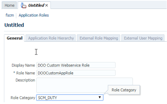

  1. Sign into the security console.
  2. Click Application Roles.
  3. On the General tab, set the values, then save your changes:
    Attribute
    Value
    Display Name
    DOO Modified Role Service
    Role Name
    DOOModifiedAppRole
    Role Category
    SCM Abstract Roles
    print of screen you use in this step.

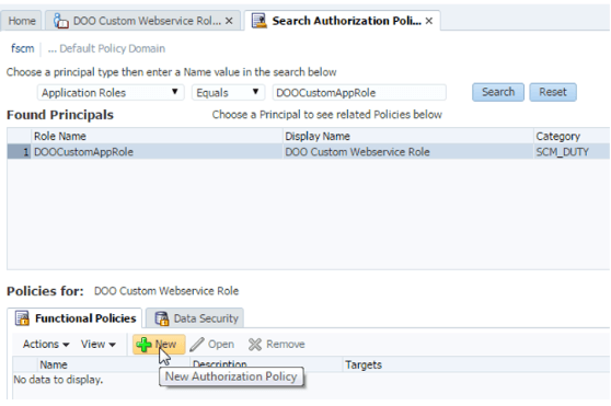

  4. Navigate to the Search Authorization Policies tab, then search for DOOCustomAppRole.
  5. In the Functional Policies tab, click New:

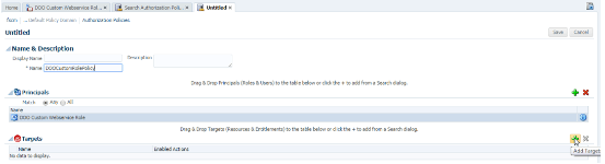

  6. In the Untitled tab, set the value, then save your changes:
    Attribute
    Value
    Name
    DOOCustomRolePolicy

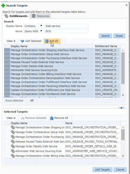

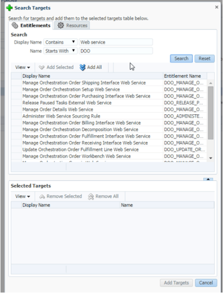

  7. In the Targets area, click Add Target.
  8. In the Search Targets dialog, set values, then click Search:
    Attribute
    Value
    Display Name Contains
    Web service
    Name Starts With
    DOO
  9. Add the privileges you need for each of the web services that you must grant to the user:

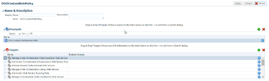

  10. Navigate to the DOOCustomRolePolicy page:

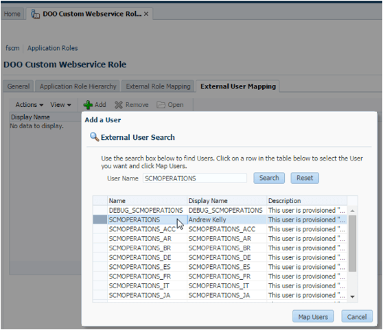

  11. In the DOO Webservice Role area, click Add.
  12. In the Add a User dialog, add a user, then click Map Users:
