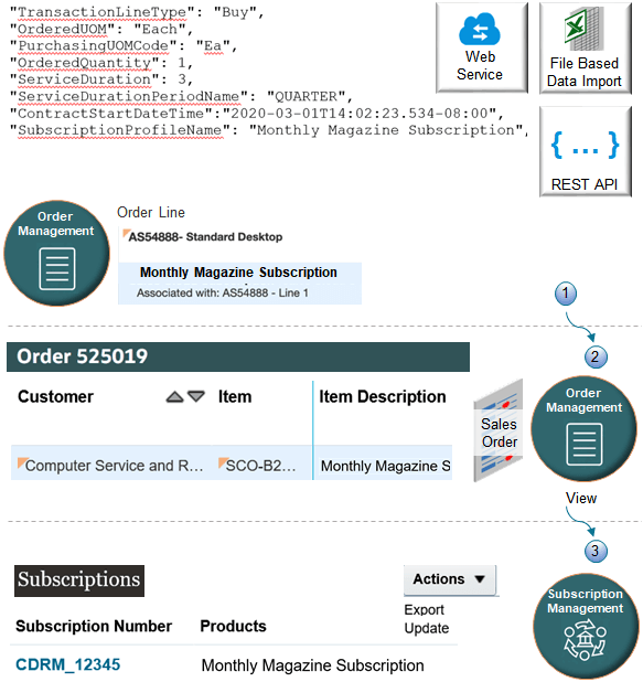

Integrate Order Management with Subscription Management
Integrate Oracle Order Management with Oracle Subscription Management so you can fulfill coverages and subscriptions in Order Management, then send them to Subscription Management.
Here's a summary of your setup.
What the numbers mean:
  1. You import the source order into Order Management through REST API, ADFi, or file based data import (FBDI). You can also add a subscription to an order line in the Order Management work area.
    Your import payload must specify all pricing for the item. Although you can use Oracle Pricing to set up pricing for your upstream system, you must include the charges or rate plan as part of your import payload, and your payload must set the Freeze Pricing attribute, Freeze Tax attribute, and Freeze Shipping Charge attribute to Y. For details, see Freeze Price on Sales Orders.
  2. You use the Order Management work area to view the coverage or subscription after you import it. You can also use the work area to revise your sales order, but pricing is frozen so don't modify the quantity unless you need to cancel the entire order line.
You use the Subscription Management work area to export or update the coverage or subscription, but only after Order Management fulfills it.

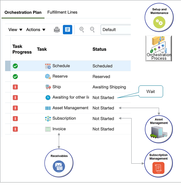

Set Up Orchestration
You can use this predefined orchestration process to orchestrate fulfillment for your subscription across Oracle Applications:
Try it:
  1. Go to Technical Reference for Order Management (Doc ID 2051639.1).
  2. Download the Integrate Subscriptions attachment.
  3. Open the attachment that you just downloaded, locate the SubscriptionIntegrationOrchestrationProcesses_20220615.zip file, then use it to import the CustomDOO_PauseforShipSubscriptionsProcess orchestration process into your environment. For details about how, see the Import subtopic in Migrate Orchestration Processes in Order Management.
Your orchestration process must wait, and then send the item to Subscription Management only after Order Management finishes fulfilling it.
If this doesn't work for you for some reason, then you will need to create your own orchestration process. If you are currently using your own orchestration process, then you must modify it. For details, see the Alternative Orchestration Process section in the Integrate Subscriptions attachment in Doc ID 2051639.1.
