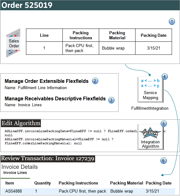

Integrate Your Own Order Line Attributes Between Order Management and Oracle Receivables
Use an extensible flexfield in Order Management to capture your own order line details, then send them to a descriptive flexfield so you can see these details on invoices in Oracle Receivables.
Note
  1. Assume you need to add your own shipping details when you create an order line for a new sales order in Order Management:
    • Packing instructions
    • Packing material
    • Packing date
  2. You will add these attributes to the Fulfillment Line Information extensible flexfield.
  3. You edit the Invoice Lines descriptive flexfield so you can display shipping details on the invoice line.
  4. You modify the FulfillmentIntegration service mapping to map the extensible flexfield between Order Management and the descriptive flexfield in Oracle Receivables.
  5. You create an integration algorithm that specifies the data to communicate.
  6. You use the Billing work area to examine the invoice that contains the shipping details.
Summary of the Setup
  1. Prepare your setup.
  2. Edit extensible flexfield.
  3. Edit service mapping for extensible flexfield.
  4. Edit descriptive flexfield.
  5. Edit service mapping for descriptive flexfield.
  6. Create integration algorithm.
  7. Test your set up.
This topic uses example values. You might need different values, depending on your business requirements.

Edit Descriptive Flexfield
Create the descriptive flexfields that Oracle Receivables will use to store the data that it receives from Order Management.
  1. Go to the Setup and Maintenance work area, then go to the Manage Receivables Descriptive Flexfields task.
  2. On the Manage Receivables Descriptive Flexfields page, search for the value:
    Attribute
    Value
    Name
    Invoice Lines
  3. In the search results, click Actions > Edit.

Identify Your Name Space and Attributes
  1. Download the descriptive flexfield:
    • Click Actions > Download Flexfield Archive, wait for processing to finish, then, in the Confirmation dialog, click Download.
    • In the dialog that displays, save the file to your preferred location.
    • Use your browser's download feature to navigate to the archive.
      For example, if you're using Firefox, click the down arrow on the top banner, then navigate to the navigate to the 222_RA_CUSTOMER_TRX_LINES file, such as C:\Users\user_name\Downloads\222_RA_CUSTOMER_TRX_LINES.zip.
  2. Unzip 222_RA_CUSTOMER_TRX_LINES.zip.
  3. Navigate to the folder.
    C:\Users\user_name\Downloads\222_RA_CUSTOMER_TRX_LINES.zip\oracle\apps\flex\financials\receivables\transactions\autoInvoices\TransactionLineDff\view
  4. Use an XML editor to open the TransactionLineFLEXVO.xml file.
  5. Search for the SdoNameSpace attribute, then copy the value of this attribute to row 5 of the memory jogger.

Edit Service Mapping for Descriptive Flexfield
Edit the service mapping so Oracle Receivables can receive the attribute details that Order Management sends.
  1. Go to the Pricing Administration work area.
    Use order administrator privileges so you can access the integration algorithm and service mappings that you use in the Pricing Administration work area to set up the integration.
  2. Click Tasks, then, under Order Management Configuration, click Manage Service Mappings.
  3. Enter your sand box.
  4. On the Manage Service Mappings page, in the Name column, click FulfillmentIntegration.
  5. Modify the entity:

Create Integration Algorithm
To implement the logic you need, you will modify the integration algorithm from another help topic.
  2. Click Tasks, and then, under Order Management Configuration, click Manage Algorithms.
  3. On the Manage Algorithms page, click Actions > Create.
  4. On the Create Algorithm page, set values:

Test Your Setup
  1. Create a sales order:
    • Go to the Order Management work area and create a sales order:
      Attribute
      Value
      Customer
      Computer Service and Rentals
    • Add an order line and set the values on the line:
      Attribute
      Value
      Item
      AS54888
      Quantity
      1
    • Click Additional Order Details, then scroll to Additional Order Information.
    • Click Ship Instructions, then verify that the Ship Instructions contains your Packing Material and Packing Date flexfield attributes.
    • Add some test values in your flexfield attributes, then click Done:
      Attribute
      Value
      Packing Instructions
      Test value for packing instructions.
      Packing Material
      Test value for packing material.
      Packing Date
      Test value for packing date.
    • Click Submit.
      Assume your order number is 55748.
  2. Verify that Order Management correctly sends your data to Oracle Receivables:
    • Make sure you have the privileges that you need to manage Oracle Receivables. For details, see Get the Privileges That You Need to Implement Order Management.
    • Go to the Billing work area, then click Tasks > Manage Transactions.
      For details, go to Using Receivables Credit to Cash, then search for Requirements for Completing a Receivables Transaction.
    • On the Manage Transactions page, search for the transaction:
      Attribute
      Value
      Business Unit
      Vision Operations
      Transaction Source
      Distributed Order Orchestration
      Reference
      55748
    • On the Review Transaction page, in the Invoice Details area, verify that the invoice contains attributes and attribute values for packing instructions, packing material, and packing date.
