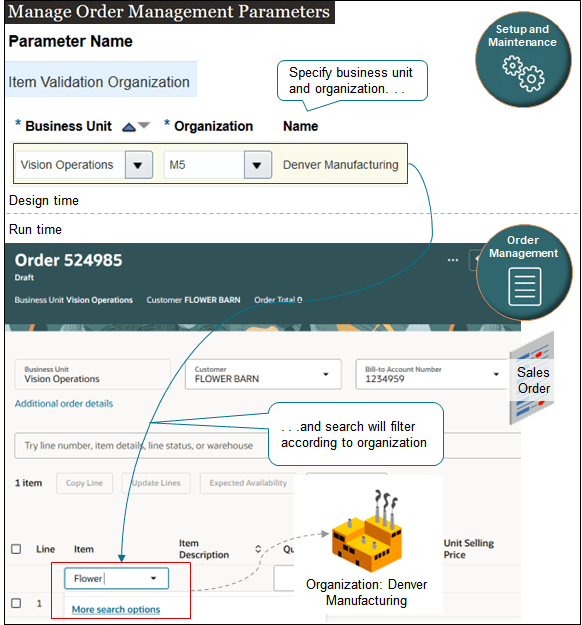

Use the Item Validation Organization parameter to specify the organization that validates whether fulfillment for the item is correct, and to make sure it meets your users' and customers' needs.
For example, you can specify the organization that Order Management uses to filter the items that you search for on a sales order, according to your business unit. Order Management will display only the items that it associates with the organization that you specify.
Assume your Vision Operations business unit only sells items that the Denver Manufacturing organization builds, so you must filter search so it only returns items from Denver Manufacturing:
Try it.
Go to the Manage Order Management Parameters page and click the row that contains the value:
Attribute
Value
Parameter Name
In the Values area, click Add Row, then set the values:
Attribute
Value
Business Unit
Vision Operations
Organization
The Organization attribute only displays values that Product Management associates with the business unit that you select in the Business Unit attribute. You can use Product Management to set up an inventory organization and create these associations.
Go to the Order Management work area, create a sales order, and set the Business Unit to Vision Operations.
Search for an item on the order line.
Verify that the search returns only the items that Denver Manufacturing builds.

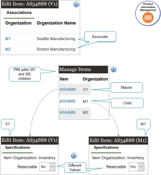

There's a Master Organization, and it Has Children
You can set attributes for an item in Product Management at the master level and the child level:
Note
You create the master first and set its attributes.
You then click Associations to add an inventory organization as a child of the master. This way, the downstream flow can create a work definition during manufacturing.
Product Management automatically creates a duplicate of the master when you add the child, but with a few important differences, such as the organization:
Assume you add M1 to V1. To see them, go to the Manage Items page and query for your item. You will see V1 and M1 on separate rows, but with different values in the Organization column.
V1 is the master. V1 means Vision Operations, which is headquarters for Vision Corporation. They keep all the masters.
M1 and M2 are children. M1 means Seattle Manufacturing, and M2 means Boston Manufacturing.
You can edit V1 and M1 separately. M1 and M2 inherit most of their attribute values from V1, but you might need to set attributes for M1 and M2 differently from what you set for the master to meet the unique needs that each manufacturing plant has. For example, you can set the Reservable attribute to No on the master and then set it to Yes on the child.

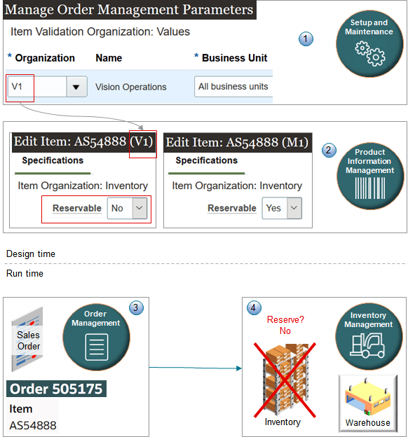

Specify the Item Validation Organization
Order Management uses attribute values that you set for the item in Product Management during fulfillment depending on how you set the Item Validation Organization parameter.
Consider an example:
Note
You set the Item Validation Organization parameter to V1 for all business units.
You set the Reservable attribute in Product Management to No for the V1 master, and you set it to Yes for the M1 child.
At run time, you create a sales order for an item that's in the V1 organization. Order Management will use the values that you specify for V1 in Product Management. It doesn't use values from the child, and because you usually specify the inventory organization as the child, that means it won't use values from the inventory organization when it fulfills your sales order.
The orchestration process won't reserve inventory for the item during fulfillment because it uses values from the master, not the child.
