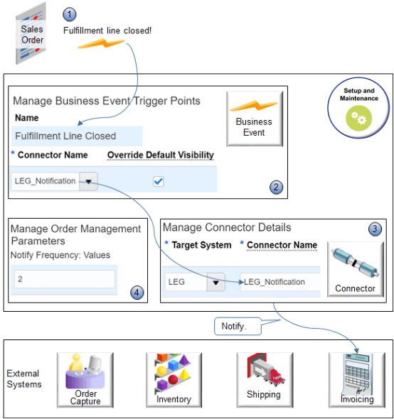

Here's how it works:
how you can use a business event to communicate
Note
  1. Order Management monitors conditions that happen during order fulfillment according to the trigger points that you specify.
    For example, if you enable the Notify External System option for the Shipped status value on a status rule set, then Order Management communicates the business event each time it sets an order line status to Shipped, and it sends the business event to the endpoint URL of the connector that you set up for the Fulfillment Line Status Update business event. For details, see Add Status Conditions to Order Lines.
  2. You use the Manage Business Event Trigger Points page in the Setup and Maintenance work area to specify the trigger point. If Order Management determines a trigger point happened, then it uses the Connector Name attribute on the Manage Business Event Trigger Points page to identify the connector it will use to communicate with the system.
  3. The connector communicates with the system. You use the connector to specify the URL that locates the system and the security credentials that your system needs to communicate data. For example, the order line status is Shipped, so you notify your invoicing system that the order is ready to invoice.
  4. As an option, you can use the Notify Frequency parameter to specify how frequently Order Management sends notifications. For details, see Manage Order Management Parameters.
You can also use a web service to communicate details about the event.
