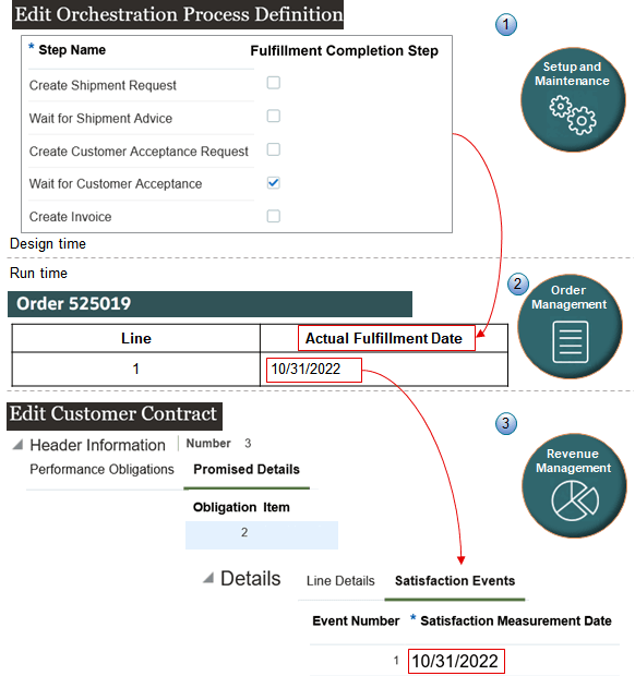

Example
Assume you need to recognize revenue according to the date that your customer accepts the item, you ship the item on 10/26/2022, and your customer accepts the item on 10/31/2022. Here's what you need to do.

  2. Add a new step in the orchestration process that you use to fulfill the item. Add it after the Wait for Shipment Advice step and before the Create Invoice step:
    Attribute Value
    Step Name Create Customer Acceptance Request
    Step Type Service
    Fulfillment Completion Step Not Enabled

  3. Add another step immediately after the Create Customer Acceptance Request step:
    Attribute Value
    Step Name Wait for Customer Acceptance
    Step Type Service
    Enabled

  4. Send the TaskFulfillmentDate in the delayed response. In this example, the TaskFulfimmentDate is the Customer Acceptance Date of 10/31/2022. The orchestration process will send the 10/31/2022 fulfillment date that's on the order line when it finishes the wait step. You can send the delayed response two minutes after you send the immediate response.
  5. Set up the Extract Sales Orders for Revenue Management scheduled process so it runs on a schedule. For details, see Integrate Order Management with Revenue Management.
  6. Create a sales order, add an order line, click Submit, then notice the sales order number. Assume it is 54759.
    The Wait for Customer Acceptance step will set the order line's Fulfillment Date attribute to 10/31/2022 when the orchestration process fulfills the line.
  7. Wait for the Extract Sales Orders for Revenue Management scheduled process to run.
    The scheduled process will send the order line's Actual Fulfillment Date attribute to Revenue Management.

    • On the Edit Customer Contract page, click Promised Details, then click Satisfaction Events.
    • Verify the value:
      Attribute Value
      Satisfaction Measurement Date 10/31/2022
