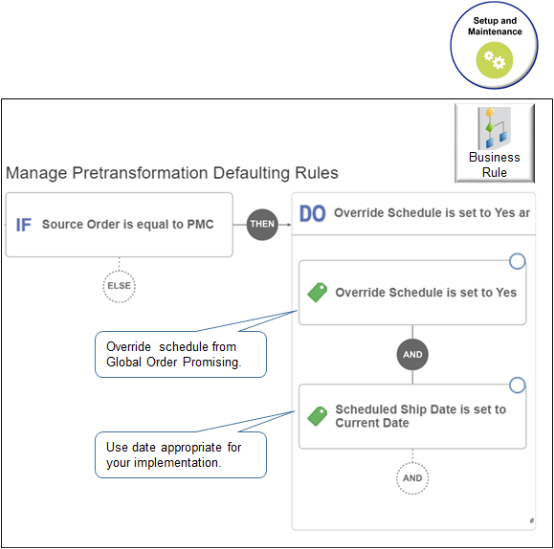

Set the default value for the Schedule Ship Date attribute on the order line.
You will create an example rule:
  • If the source order header includes PMC, then set the default value for Scheduled Ship Date to the current date.
Note
  • Use Visual Information Builder.
  • Enter Source Order (Order Header) when you create the If clause.
  • Enter values when you create the Then clause:
    • Override Schedule (Order Fulfill Line)
    • Scheduled Ship Date (Order Fulfill Line)
