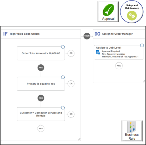

  • If the order total is greater than $10,000, and if the Primary is yes, and if the customer is Computer Service and Rentals, then request and get approval from a manager.
Here's the rule that you will create:

  6. Name the If statement so it reflects the meaning of the condition:
    • Click Enter Description.
    • In the Enter Description dialog, enter High Value Sales Orders, then click OK.
  7. Click New Condition (the dashed circle in the IF area).
  8. In the Create Condition dialog, enter order total, wait a moment, then click Order Total Amount (Order Header > Order Totals).
    Notice that the dialog displays suggestions when you wait a moment after you finish typing.
  9. In the Create Condition dialog, set the values, then click OK:
    Field
    Value
    Attribute
    Order Total Amount
    Condition
    greater than ( > )
    Value
    10000
    Notice that the IF area now displays the condition:
    • Order Total Amount > 10,000
  10. Click Save.
Create the First AND
  1. Click AND.
  2. In the Create Condition dialog, enter primary, wait a moment, then click Primary (Order Header > Order Totals).
  3. In the Create Condition dialog, set the values, then click OK:
    Field
    Value
    Attribute
    Primary
    Condition
    Is equal to
    Value
    Yes
    • Primary is equal to Yes
  4. Click Save.
Create the Second AND
  1. Below Primary is equal to Yes, click AND.
  2. In the Create Condition dialog, enter customer, wait a moment, then click Customer (Order Header).
  3. In the Create Condition dialog, set the values:
    Field
    Value
    Attribute
    Customer
    Condition
    Equals ( =)
  4. Click Search.
  5. In the Search dialog, in the Name attribute, enter Computer Service and Rentals, then click Search.
  6. In the search results, click Computer Service and Rentals, then click OK.
  7. In the Create Condition dialog, click OK.
    • Customer = Computer Service and Rentals
  8. Click Save.

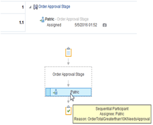

  3. Click View Approval Information, then verify the approval details reflect the approval rule you created:
    rule that includes approval information that reflects the approval rule that you created
