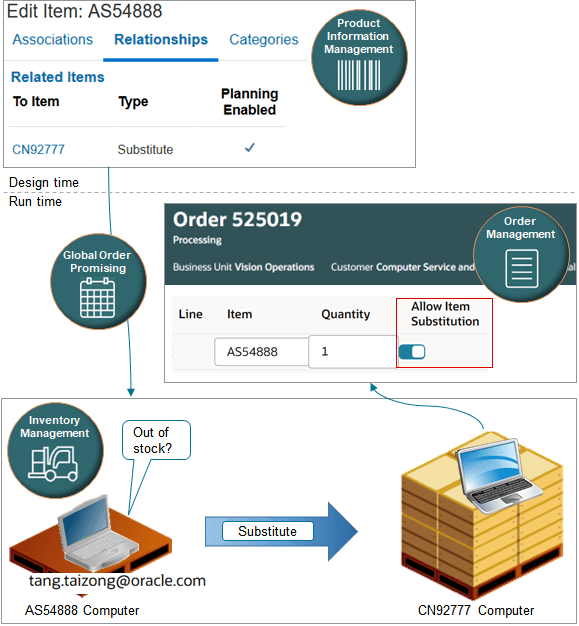

You can use the Substitute action or the Check Availability action in the Order Management work area to substitute an item. You can also use Global Order Promising to substitute an item. This topic describes how to use Global Order Promising:
You use the Product Management work area to specify the item to substitute at design time.
Note
  • You use the Product Management work area to specify the item to substitute at design time.
  • At run time, the Order Entry Specialist creates a sales order in the Order Management work area and clicks Submit.
  • Fulfillment fulfills the item:
    • The scheduling fulfillment task in your orchestration process calls Global Order Promising.
    • Global Order Promising communicates with Inventory Management to determine whether the item is out of stock.
    • If its out of stock, and if the Allow Item Substitution attribute on the sales order is Yes, and if Global Order Promising determines that the substitute item is available, then Global Order Promising sends a recommendation to Order Management to use it, and Order Management uses the substitute to fulfill the order line.
