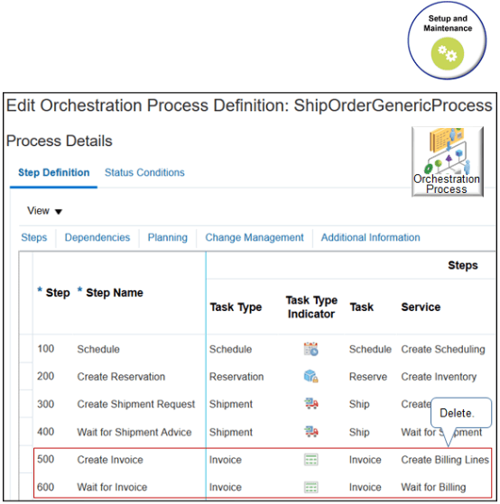

  1. Go to the Setup and Maintenance work area, then enable the Process Sales Orders for Projects opt-in feature in the Manufacturing and Supply Chain Materials Management offering. See Opt Into Features in Order Management.
  2. Modify the orchestration process:
    • Go to the Manage Orchestration Process Definitions task.
    • On the Manage Orchestration Process Definitions page, search for ShipOrderGenericProcess, then click Actions > Edit.
    • On the Edit Orchestration Process Definitions page, click Actions > Revise Process.
    • In the Process Details area, delete the Create Invoice step and the Wait for Invoice step:
      Page Edit Orchestration Process Definitions
    • Deploy your orchestration process, then click Save and Close.
    • On the Manage Orchestration Process Definitions page, click Cancel.
