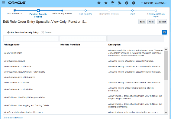

  6. On the Function Security Policies page, delete all rows except rows that contain these privileges:
    • Monitor Sales Order
    • View Customer Account
    • View Customer Account Contact
    • View Customer Account Contact Responsibility
    • View Customer Account Information
    • View Customer Account Site
    • View Customer Account Site Use
    • View Fulfillment Line Freight Charges and Cost
    • View Fulfillment Line Shipping and Tracking Details
    • View Item
    • View Item Organization Association
    • View Item Relationship
    • View Orchestration Infrastructure Messages
    • View Orchestration Order Fulfillment Line Hold
    • View Orchestration Order Hold
    • View Orchestration Order Line Hold
    • View Orchestration Process Details
    • View Orchestration Process Hold
    • View Order Orchestration Request Messages
    • View Orders
    • View Planning Supply Availability
    • View Supply Availability Report
    • View Supply Chain Financial Orchestration System Options
    • View Supply Orders
    For example:
    the Function Security Policies page.

    For details about the role hierarchy that each predefined job role uses, see the Security Reference for Order Management book.
  11. Click Next.
  12. On the Users page, click Add User.
  13. In the Add User dialog, search for Yu Li, wait for the results to display, click Add User to Role > OK in the confirmation dialog, then click Cancel.
  14. Click Next > Save and Close.
