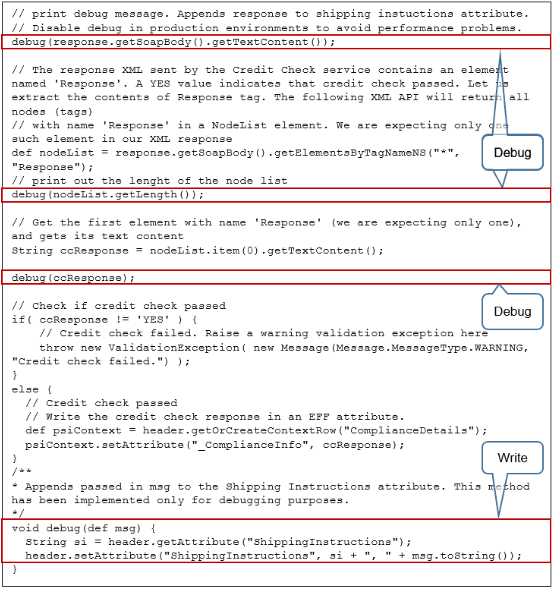

Use the Debug Method
Use the Debug method at various points in your code during development to write variables and other values to an attribute that you can examine in work area Order Management. This example calls debug three times, then writes the contents of debug into the ShippingInstructions attribute:
Using the Debug method at various points in your code
You can then write your code so it displays these contents in the Shipping Instructions attribute in the Order Management work area, then examine this display output to determine the values of various attributes and variables that exist at various points in your code.
When you're ready to deploy to production, modify void debug. For example, assume you use this code to write your debug contents.
void debug(def msg)
 {String si = header.getAttribute("ShippingInstructions");
 header.setAttribute("ShippingInstructions", si + ", " + msg.toString());
Modify this code so it writes to the log. You replace header.setAttribute with logger.logFine. For example:
void debug(def msg)
 logger.logFine("ShippingInstructions", si + ", " + msg.toString());
Use this approach so you can change only a single line in your code, which is useful if you have 10s of lines that call debug. You can also comment each line that calls the debug method, but commenting runs the risk of missing lines that call debug, or accidentally commenting a line that doesn't call debug but that's critical to your code logic.
