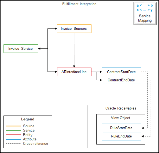

Assume you must:
  • Integrate ContractStartDate in Order Management with RuleStartDate in Oracle Receivables
  • Integrate ContractEndDate in Order Management with RuleEndDate in Oracle Receivables
You will modify the predefined FulfillmentIntegration service mapping so it uses these cross-references:
mapping of view object to integrate with Oracle Receivables, Oracle Shipping, Oracle Receiving, or Oracle Procurement
This topic uses example values. You might need different values, depending on your business requirements.

  7. In the InvoiceSources Details area, click the row that contains ARInterfaceLine in the Entity attribute.
  8. In the ARInterfaceLine Details area, add values, then click Save:
    Attribute
    View Object Attribute
    RuleStartDate
    ContractStartDate
    RuleEndDate
    ContractEndDate
The RuleStartDate and RuleEndDate are now integrated to reference the view objects that you specified. Here's what Order Management does at run time:
  • Get the value of the ContractStartDate attribute from the Order Management work area, then display it in the RuleStartDate attribute in Oracle Receivables.
  • Get the value of ContractEndDate from the Order Management work area, then display it in the RuleEndDate attribute in Oracle Receivables.
