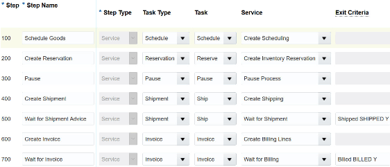

Add Orchestration Process Steps
You will add these steps:
Try it.
  1. On the Step Definition tab, click Actions > Add Row.
  2. Set the values, then click Save:
    Attribute
    Value
    Step Name
    Schedule Goods
    Step Type
    Service
    Task
    Schedule
    Service
    Create Scheduling
  3. Add more steps. Repeat steps 1 and 2. Use these values:
    • Create Reservation
    • Create Shipment
    • Wait for Shipment Advice
    • Create Invoice
    • Wait for Invoice
    Note
    • Set the Step Type attribute for all steps to Service.
    • Set other attributes so they reflect step behavior.
      For example, for the Create Reservation step, set these values:
      Attribute
      Value
      Step Type
      Service
      Task
      Reserve
      Service
      Create Inventory Reservation
    • Make sure you set the Exit Criteria attribute for each wait step. For example, set Exit Criteria for the Wait for Shipment Advice step to Shipped.
  4. Add the pause step. Click the Create Reservation step, click Add Row, set the values in the new row, then click Save:
    Attribute
    Value
    Step Name
    Pause
    Step Type
    Service
    Task
    Pause
    Service
    Pause Process

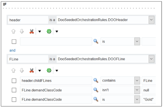

Create If Statement for First Rule
You will create the start-after condition. This condition determines whether the customer is Gold.
You will create this If statement:
where
  • DOOFLine is a function in the DooSeededOrchestrationRules dictionary.
  • DOO is an abbreviation for distributed order orchestration, which is an earlier name for order orchestration.
  • FLine is an abbreviation for order line.
  • demandClassCode is an order line attribute. This attribute stores the customer class, such as Gold, Silver, or Bronze.
  • isn't determines whether demandClassCode contains Gold.
  • For details, see Guidelines for Pausing Orchestration Processes.
Create the If statement for the first rule.
  1. Create the rule:
    • On the Pause step, in the Pause Rule column, click Click for Rule.
    • In the Start After Condition dialog, click Add Rule, then replace Rule 1 with Pause for Gold Customers.
    • Click Properties, then add check mark to Advanced Mode.
  2. Specify the dictionary and facts to examine:
    • In the IF area, in the window to the left of Is A, enter header.
    • Set the window to the right of Is A to DooSeededOrchestrationRules.DOOHeader.
    • Click Add Pattern.
    • In the window to the left of Is A, enter FLine.
    • Set the window to the right of Is A to DooSeededOrchestrationRules.DOOFLine.
  3. Make sure to evaluate only order lines:
    • Under FLine, click Add Test.
    • Click Left Value.
    • In the Condition Browser, expand Header, click ChildFLines, then click OK.
    • Change Is to Contains.
    • Click Right Value.
    • In the Condition Browser, click FLine, then click OK.
  4. Make sure the attribute you're about to test isn't empty:
    • On the test you just added, to the far right, click the down arrow, then click Simple Test.
    • On the new line that displays, click Left Value.
    • In the Condition Browser, expand FLine.
      Notice that each value under FLine references an order line attribute.
    • Click demandClassCode, then click OK
    • Change Is to Isn't.
    • In the Condition Browser, click null, then click OK.
  5. Determine whether the customer is Gold:
    • Click demandClassCode, then click OK.
    • In the Right Value window, enter "Gold".
      You must include the double quotation marks ( " " ).

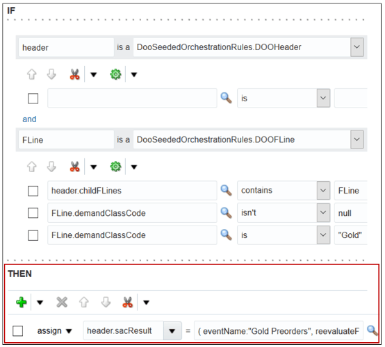

Create Then Statement for First Rule
You will create this Then statement:
For brevity, this screen print doesn't include the entire value for the event.
Create the Then statement for the first rule.
  1. In the Then area, click Add Action > Assign.
  2. Click Select a Target, then click header.SacResult.
  3. In the window to the right of the equal sign ( = ), enter this value.
    ( eventName:"Gold Preorders", reevaluateFlag:"N",sacType:DooSeededOrchestrationRules.SacResult.SAC_TYPE_EVENT )
    where
    • eventName is a variable that you can use to help track the the pause task's status. The Order Management work area uses the text you enter wherever it displays status details.This example specifies to use the Gold Preorders event.
    • reevaluateFlag:"N" specifies not to evaluate this rule again.
    • sac is an abbreviation for start after condition.
    • sacType specifies the dictionary, rule set, and event to use for the start after condition.
    • DooSeededOrchestrationRules is a dictionary that contains predefined rules you can use in your business rule.
    • is a rule set in DooSeededOrchestrationRules. It contains events and variables you can use to specify how to handle the result of a start after condition.
    • EVENT is an event in SacResult. It specifies to use a business event.
    • A pause type of EVENT causes the orchestration process to pause until an event happens.
    • An attribute on an orchestration process references this event, but you can also use it with a web service. You can also use other parameters to release a pause task. This event isn't related to the events that the event framework in Oracle Middleware uses.
    • You must include double quotation marks ( " " ).
  4. Click Save.

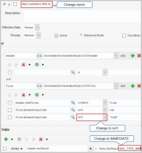

Create the Second Rule
You will create this rule:
the Second Rule
Try it.
  1. On the Pause step, in the Pause Rule column, click Click for Rule.
  2. In the Pause Rule Set dialog, in the check box to the left of Pause for Gold Customers, add a check mark.
  3. Click Cut > Paste.
  4. Scroll down to the bottom of the dialog and notice the rule that the paste added.
  5. Make these changes to this new rule:
    Replace This Value
    With This Value
    Skip Customers Who Are Not Gold
    FLine.demandClassCode is "Gold"
    FLine.demandClassCode isn't "Gold"
    header.sacResult = ( eventName:"Gold Preorders", reevaluateFlag:"N",sacType:DooSeededOrchestrationRules.SacResult.SAC_TYPE_EVENT )
    header.sacResult = ( eventName:"Gold Preorders", ( reevaluateFlag:"N", sacType:DooSeededOrchestrationRules.SacResult.SAC_TYPE_IMMEDIATE )
    Start after condition IMMEDIATE ends the pause task and allows the orchestration process to continue to the next step.
  6. Click Save.
  7. On the Edit Orchestration Process Definition page, click Save.
