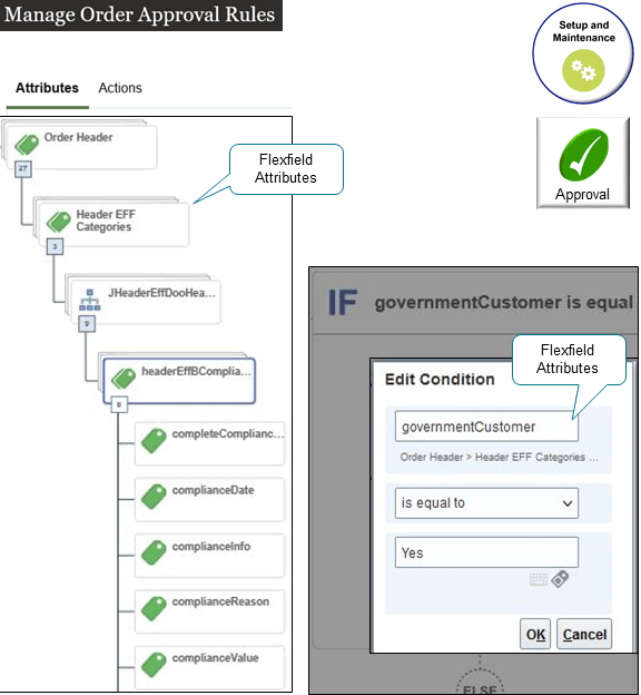

    Assume you're adding a flexfield on the order header:
    • Go to the Setup and Maintenance work area, then open the Manage Order Approval Rules task.
    • On the Manage Order Approval Rules page, click Create New Rule.
    • In the Attributes area, click Order Header > Header EFF Categories.
      Notice that the Header EFF Categories tree contains the categories that you created in step 1.
    • Click New Condition.
    • In the Create Condition dialog, enter Header.
    • Click HeaderId (Order Header > Header EFF Categories).
    • Notice how the dialog contains the categories that you created in step 1.
