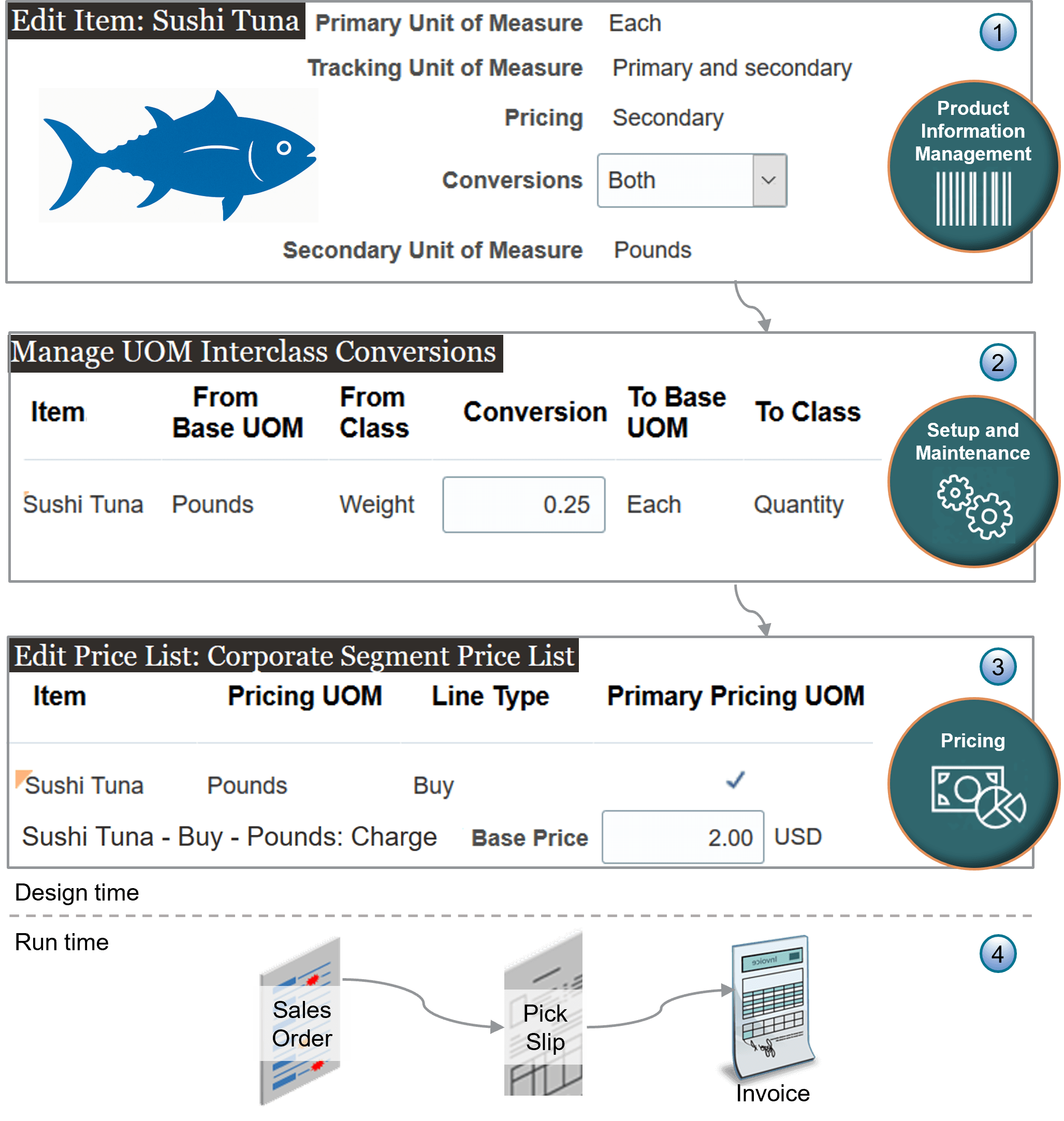

Set up
Set up dual units of measure so you can order, price, manufacture, receive, pick, pack, and ship an item in the primary measure but price it in the secondary measure.
Assume you're in the Fresh Fish 4 U organization, and you're a fishmonger who sells an item named Sushi Tuna. You capture tuna in the open ocean and bring them to port every day, where you sell the whole fish to your favorite restaurateur, Fancy Fish.
You price it by pound, not by each fish, so you need to price it in the secondary measure. Sushi Tuna is a good candidate for dual measures because a tuna naturally varies in size, you typically sell each tuna as one fish each, but you price it by weight. You sell each tuna fish for a different amount because each one has a unique weight. You need to track the item in the primary measure and secondary measure throughout your order fulfillment lifecycle.
Here's your work map:
xxxxxxxxxxxxxxxxxxxxxxx
Summary of the Setup
  1. Create the item.
  2. Manage the conversion.
  3. Set up pricing.
  4. Test your work.

Create the Item
  1. Go to Home > Product Management > Product Management > Tasks > Create Item.
    You must create a new item. You can't add dual measures to an item that already exists.
  2. In the Create Item dialog, set the values:
    Attribute
    Value
    Organization
    Fresh Fish 4 U
    Create New
    Enabled
    Number of Items
    1
    Item Class
    Root Item Class
  3. Make sure the Selected List window contains only Finished Goods, then click OK.
  4. On the Create Item page, set the values:
    Attribute
    Value
    Item
    Sushi Tuna
    Description
    The world's tastiest tuna. Remember, you can tune a piano, but you can't tune a fish.
    Primary Unit of Measure
    Each
    Specify the unit of measure that you use to stock and sell and the item.
    Tracking Unit of Measure
    Primary and Secondary
    Specify how to track your on-hand balance.
    If you set it to Primary and Secondary, then you're telling Order Management that this item is a dual measure item.
    Pricing
    For this example, choose Secondary.
    See Price.
    Conversions
    Both
    Secondary Unit of Measure
    Pounds
    Specifies the measure that you use to price the item.
    Defaulting Control
    Choose a value:
    • Default. Use when your item's secondary measure might change at run time.
    • Fixed. Use when your item's secondary measure won't change at run time.
    You can't change some of the values that you set in the Unit of Measure area after you save, so make sure you set them correctly.
  5. Click Specifications > Manufacturing, then set the value:
    Attribute
    Value
    Structure Item Type
    Standard
    You must use Standard.
  6. Click Sales and Order Management, then set the values:
    Attribute
    Value
    Sales Product Type
    Goods
    You must use Goods or leave it empty.
    Shippable
    Yes
    Can be Yes or No.
    Invoiced
    Yes
    Invoice Enabled
    Yes
  7. Click Save > Save and Close.
See How You Set Up Items in Product Information Management.

Manage the Conversion
You must set up a conversion between the item's primary measure and its secondary measure. You can use the standard conversion for many items or you can set up a conversion only for the item. In this example you set up a conversion for the item:
  • 1 Pound equals 0.25 Each. If you order 1 Each of Sushi Tuna, then the value in the secondary Pounds measure is 4.
Try it:
  1. Go to Home > My Enterprise > Setup and Maintenance > Tasks > Search > Manage Units of Measure for Interclass Conversion.
    In this example you convert between a measure that's in the Weight class and another that's in the Quantity class, so you create an interclass conversion. If your measures are in the same class, then use the Manage Units of Measure for Intraclass Conversion task.
  2. On the Manage UOM Interclass Conversions page, click Change Organization, set the value, then click OK:
    Attribute
    Value
    Organization
    Fresh Fish 4 U
  3. Click Actions > Add, set the values, then click Save and Close:
    Attribute
    Value
    Item
    Sushi Tuna
    From Base UOM
    Pounds
    From Class
    Weight
    Conversion
    0.25
    You sell the Bullet Tuna species. Assume each of these tuna averages about 4 pounds each.
    To Base UOM
    Each
    To Class
    Quantity
  4. Set up a standard conversion.

Set Up Pricing
Assume you use the Corporate Segment Price List, and the sale price for tuna on the commercial market is about $2 a pound
You specify the Pounds measure as the primary. This way, pricing will price it by the pound, not by each. You specify 2.00 USD as the base price, so you charge $2 for each pound of tuna:
  1. Go to Home > Order Management > Pricing Administration > Manage Price Lists.
  2. Search for and open the Corporate Segment Price List.
  3. On the Edit Price List page, click Actions > Add Row, set the values, then click Save:
    Attribute
    Value
    Item
    Sushi Tuna
    Pricing UOM
    Pounds
    Line Type
    Buy
    Primary Pricing UOM
    Selected.
    Enabling this option tells Pricing to use the value that you set in the Pricing UOM attribute to price the item.
    Don't confuse the Primary Pricing UOM attribute with the Primary Unit of Measure attribute that you set for the item in Product Management. The Primary Pricing UOM attribute is specifically for pricing, not for the item.
  4. Click Create Charge, set the values, then click Save and Close:
    Attribute
    Value
    Pricing Charge Definition
    Sale Price
    Calculation Method
    Price
    Base Price
    2
    Allow Manual Adjustment
    Selected.
    Market conditions probably vary every day, so let your users adjust the price manually.
See Manage Price Lists.

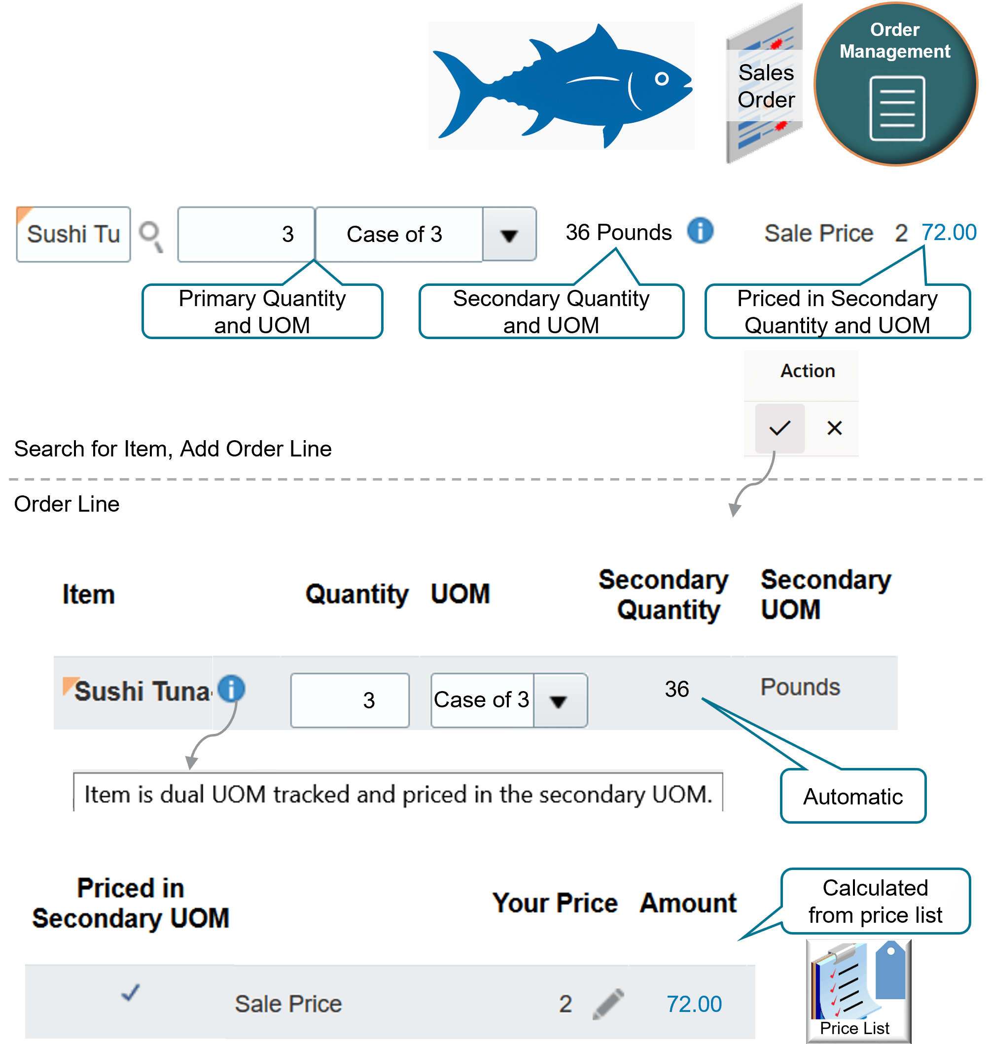

Test Your Work
  1. Go to the Order Management work area and create a sales order:
    Attribute
    Value
    Customer
    Fancy Fish
    Business Unit
    Fresh Fish 4 U
  2. Search for and add the Sushi Tuna item on the order line:
    xxxxxxxxxxxxxxxxxxxxxxxxxxxxxxxx
    Note
    • You use the order line to search for the item. It displays the quantity and price for the primary measure and the secondary measure.
    • You can't change the secondary quantity or secondary measure on the order line, but you can change the primary quantity and Order Management will automatically calculate the secondary quantity and the amount.
    • The order line sets the unit of measure to the primary, by default. It also displays primary and secondary attributes which makes it easy to see the conversion.
  3. Assume you change the Quantity to 3 and the UOM attribute to Case of 3:
    Attribute
    Value
    Quantity
    3
    This is the primary quantity.
    UOM
    Case of 3
    The primary measure of the item is Each. You can change it to any measure that's in the primary measure's class, such as Case of 3.
    Secondary Quantity
    36
    The order line uses your conversion rules to automatically calculate the secondary quantity:
    • 1 case contains 3 tuna.
    • 1 tuna equals 4 pounds.
    • 3 tuna multiplied by 4 pounds means each case weighs 12 pounds.
    • 12 pounds for each case multiplied by the primary quantity of 3 equals a secondary quantity of 36.
    Secondary UOM
    Pounds
    Sale Price
    2
    Line Price
    72.00
    Its the secondary quantity of 36 pounds multiplied by the unit price of 2 equals 72.00.
    Information Icon
    Let's you know that you're using dual measures for this item.
  4. Click Add, then notice that the sales order adds the values that you set on the order line. Here are a few more details you should take note of:
    Attribute
    Value
    Item
    Contains your dual measure item.
    Priced in Secondary UOM
    Contains a value:
    • Selected. Pricing priced the order line according to the value in the Secondary UOM attribute on the order line. In this example, that would be Pounds.
    • Not Selected. Pricing priced the order line according to the value in the UOM attribute on the order line. In this example, that would be Each.
    Order Management gets this value from the Pricing attribute that you set in Product Management.
  5. Click Submit.
    • The orchestration process schedules and reserves the item just like it does any other sales order. It schedules the order according to the order line's Quantity attribute and UOM attribute.
    • The secondary measure and the secondary quantity doesn't affect scheduling.
Assume the order number is 525940. Here's part of the order line:
Line
Item
Quantity
UOM
Status
Secondary Quantity
Secondary UOM
Price
Extended Amount
Assessable Value
Shipped Quantity
Secondary Shipped Quantity
Secondary Fulfilled Quantity
1
Sushi Tuna
3
Case of 3
Awaiting Shipping
36
Pounds
$2
$72
$72
empty
empty
empty
