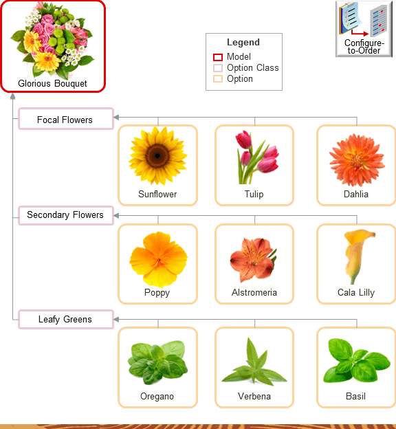

Assume you set up this assemble-to-order configuration model:
Next, you go to the Order Management work area:
- You add the bouquet to an order line.
- The work area displays this structure, and you select your
options:
Glorious Bouquet Focal Flowers Sunflower Tulip Dahlia Secondary Flowers California Poppy Alstroemeria Cala Lilly Leafy Greens Oregano Verbena BasilItalics indicate the options that you selected.
