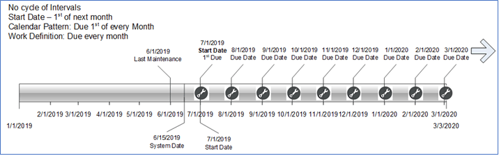

Example 1: Maintenance is due on the first of every month and doesn't have a cycle of intervals. Maintenance was last accomplished for the Asset on Jun 1 (before starting this new program) and is next due on July 1. In this example, the first due begins on the start date and not from a historical last completed maintenance date.
  • Setting a start date of Jun 23, before the first of the next month, means the first/next due is July 1 and is then due every month from that point forward.

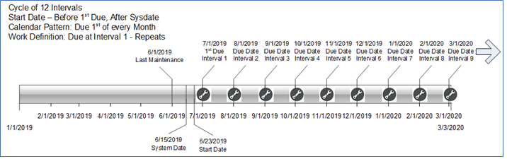

Example 2: Maintenance is due on the first of every month on a cycle of 12 intervals. This is the same as Example 1, it just uses a repeating interval, and the work definitions are due at each interval. Maintenance was last accomplished for the Asset on Jun 1(before starting this new program) and is next due on July 1. In this example, the Intervals begin on the start date and not from a historical last completed maintenance date and interval.
  • Setting a start date of Jun 23, before the first of the next month, along with a monthly repeating pattern means the first/next due is July 1 and is then due every month from that point forward.
Cycle Interval and Start Date Example-2

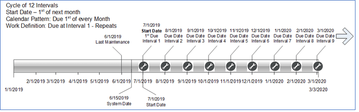

Example 3: Same as Example 2 but set the start date = First Due date and Interval.
  • Setting a start date of July 1 along with a monthly repeating pattern means the first/next due is July 1 at Interval 1 and is then due every month from that point forward. This is the same behavior as example 2.

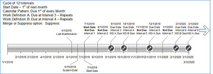

Example 4: Maintenance is due on the first of every month on a cycle of 12 intervals. This is like Example 3 however it has 2 work definitions due at different intervals. When they overlap, the rule is to Suppress the lower interval work definition. Maintenance was last accomplished for the Asset on Jun 1 (before starting this new program) and is next due on July 1. In this example, the Intervals begin on the start date and not from a historical last completed maintenance date and interval.

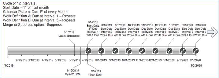

Example 5: This is also like example 4; however, it has 2 work definitions due at different intervals. When they overlap, the rule is to Merge all work definitions. Maintenance was last accomplished for the Asset on Jun 1 (before starting this new program) and is next due on July 1. In this example, the intervals begin on the start date and not from a historical last completed maintenance date and interval.

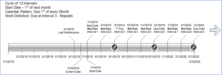

Example 6: Maintenance is due on some months, on the first, over a cycle of 12 intervals. When it's due, it can be one or the other work definition. When they overlap, the rule is to Suppress the lower interval work definition. Maintenance was last accomplished for the Asset on Jun 1 (before starting this new program) and is next due on Sept1 at a future interval. In this example, the Intervals begin on the start date and not from a historical last completed maintenance date and interval.
  • Setting a start date of Jun 23, before the first of the next month, along with a monthly repeating pattern means the first/next due is Sept 1 on Interval 3 and is then due every interval where a work definition falls due.
  • Note that Intervals 1, 2, 5, 7, 10, and 11 are skipped. Interval 12 has Work Definition B suppress A.
Cycle Interval and Start Date Example-6

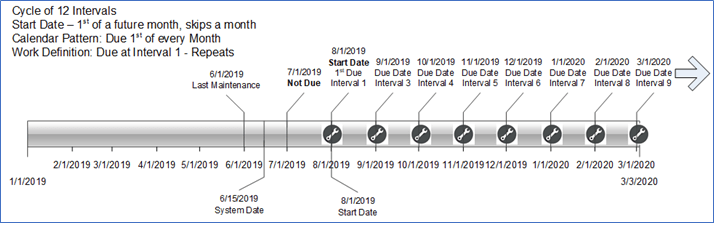

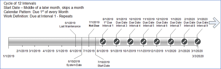

Example 7: Maintenance is due on the first of every month on a cycle of 12 intervals. Maintenance was last accomplished for the Asset on Jun 1 (before starting this new program). However, it is not required to be due again until August 1. In this example, the Intervals begin on the start date after Jul 1 and not from a historical last completed maintenance date and interval. Therefore, a due date in the future on July 1 is being skipped.
  • Setting a start date after July 1, but before Aug 1, along with a monthly repeating pattern means the first/next due is Aug 1 and is then due every month from that point forward. July 1 is skipped by design.

Example 8: Same as Example 3 but set the start date = First Due date and Interval.
  • Therefore, setting a start date of Aug 1 and monthly repeating pattern means the first/next due is Aug 1 and is then due every month from that point forward. July 1 is skipped by design. This is the same behavior as example 7.

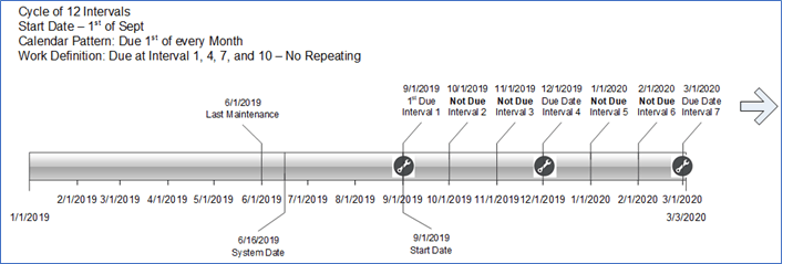

Example 10: Maintenance is due on the first of only certain months on a cycle of 12 intervals. It will be due at intervals 1,4,7, and 10. Maintenance was last accomplished for the Asset on Jun 1 (before starting this new program) and is next due on Sept 1 at Interval 1. This example, the Intervals begin on the start date and not from a historical last completed maintenance date and interval.
  • The Start date should be set so that Sept 1 is when Interval 1 begins calculating. Therefore, the start date can be on or between the system date and first due date of Sept 1.
Cycle Interval and Start Date Example-10

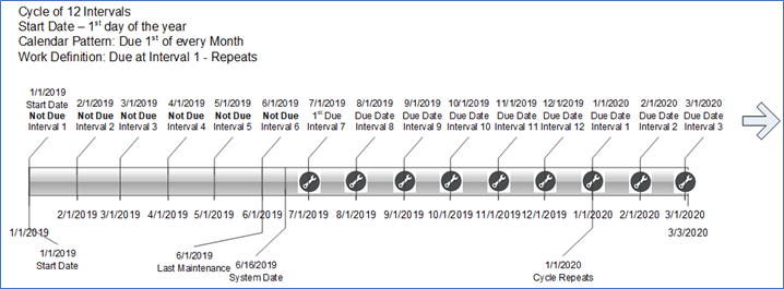

Example 11: Maintenance is due on the 1st of every month on a cycle of 12 intervals. Maintenance was last accomplished for the Asset on 1-Jun (before starting this new program) at Interval # 6. Therefore, it is next due at a specific interval # 7 on 1-Jul. This example does not use the historical last completed maintenance date and interval, but just relies on a past dated start date to sequence the next due date and interval.
  • The Start date should be set in the past to replicate the last completion at Interval 6 and initialize the forecast for the next to at Interval 7. Setting a start date of Jan1 allows an Asset to cut in its next due in the middle of a Cycle, since the first/next due will always be >= system date anyway. The Intervals can calculate in the past, but only the first due date will be in the future.
  • Note that the cycle repeats on Jan-1-2020 and starts at Interval 1 again.
Cycle Interval and Start Date Example-11

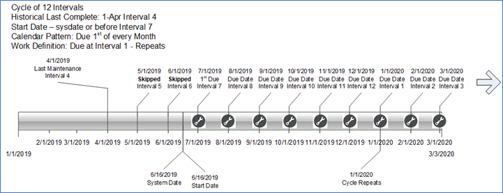

Example 12: Maintenance is due on the first of every month on a cycle of 12 intervals. Maintenance was last accomplished for the Asset on Jun 1 (before starting this new program) at Interval # 6. Therefore, it is next due at a specific interval # 7 on Jul 1. In this example, the Intervals will begin on the historical last maintenance date and interval of Apr 1 and Interval 4, instead of back at the first of the year. This example will use of the historical last completed date and interval to reach the same outcome as Example 7. For an Item-based requirement, it allows for each asset to have its individual forecast initialized.
  • Setting a start date of between or on sysdate and the first Interval 1 on Jul 1, along with a monthly repeating pattern, means the first/next due is July 1 at Interval 7 and is then due every month from that point forward.
Cycle Interval and Start Date Example-12

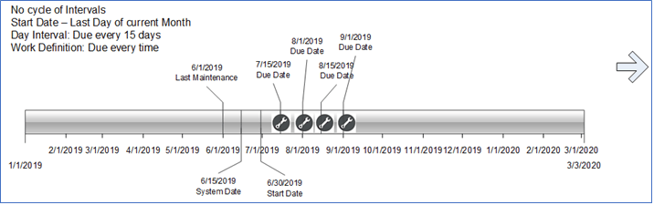

Example 1: Maintenance is due every 15 days and does not have a cycle of intervals. Maintenance was last accomplished for the Asset on 1-Jun (before starting this new program) and is next due on July 15, then every 15 days after.
  • Setting a start date of Jun 30, which will then calculate the first due = Jul 15. The Day interval starts calculating on the next day after the start date, then increments the 15 days. This is how Excel calculates dates.
    • Jul 1 + 15 days = Jul 16
    • Jun 30 + 15 days = Jul 15.
Day Interval Example-1

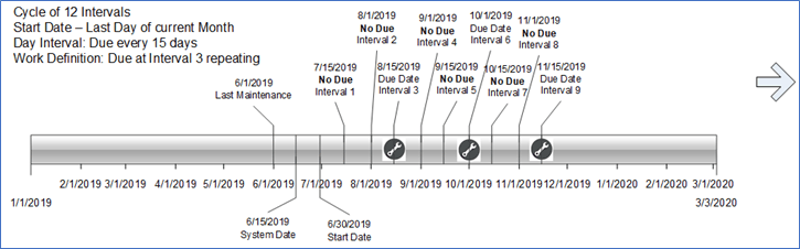

Example 2: Maintenance is due on certain intervals of a cycle of 12 intervals. The Day interval is 15 days and is due every 3 intervals (3,6,9,12). Maintenance was last accomplished for the Asset on Jun 1 (before starting this new program) and is next due on Aug 15.
  • Setting a start date of Jun 30, which will then calculate the first interval = Jul 15. The Day interval starts calculating on the next day after the start date, then increments the 15 days for each interval.
  • Since it is due every 3 intervals, the first dues is Aug 15 at Interval 3.
Day Interval Example-2
