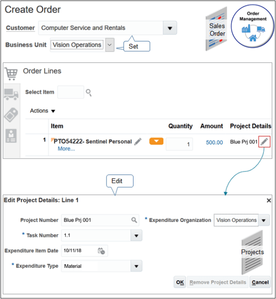

Create a sales order, then select a value in the Customer attribute and in the Business Unit attribute.
The customer, business unit, and item determines the projects that you can select on the order line, depending on how your order administrator sets up Order Management. For details, see Overview of Setting Up Projects in Order Management.
Search for an item on the order line, then add it to the order.
On the order line, in the Project Details column, click Edit Project Details.
In the dialog that displays, set values.
For example:
Click Submit.
