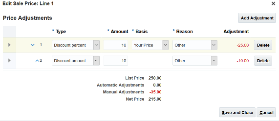

Sequence More Than One Adjustment
The Edit Sale Price dialog calculates adjustments in the same sequence it displays them. If you add more than one adjustment, then the sequence might affect price.
Assume you add these adjustments.
examples of adjustments
The dialog uses this sequence to calculate price.
Step
Description
Math
1
Calculate percent discount.
10% multiplied by $250 List Price equals $25 discount.
2
Subtract percent discount.
$250 minus $25 equals $225 Net Price.
3
Subtract amount discount.
$225 Net Price minus $10 equals final Net Price of $215.

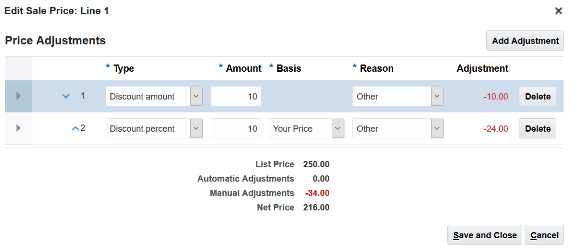

Assume you click the up arrow next to the number 2 to move discount amount to the top.
example of a sequence
Step
Description
Math
1
$250 minus $10 equals $240 Net Price.
2
Calculate 10% discount.
10% multiplied by $240 Net Price equals $24 discount.
3
Calculate final Net Price.
$240 minus $24 equals $216.
