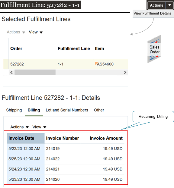

Examine Recurring Billing
You can examine recurring billing on the order line.
Try it.
  1. Open a sales order that includes recurring billing, and that you already submitted.
  2. On the Order page, click Actions > Switch to Fulfillment View.
  3. On the Fulfillment Lines tab, click a link in the Fulfillment Line attribute, such as 1-1.
  4. On the Fulfillment Line page, click Actions > View Fulfillment Details.
  5. In the dialog that displays, click Billing, then examine the recurring billing.
